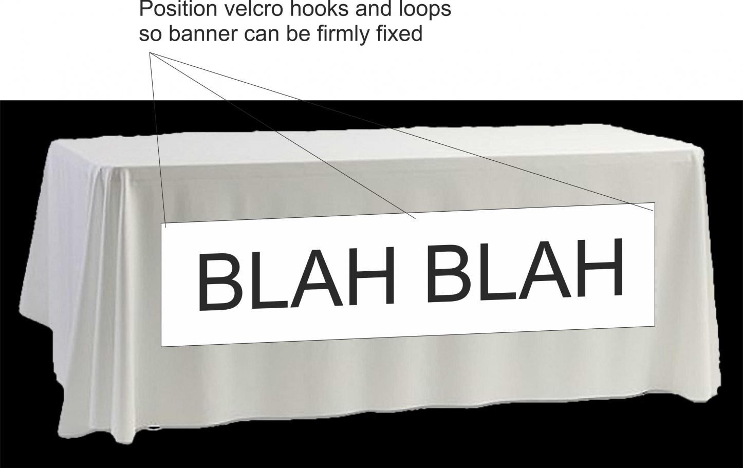

Find a table cloth that is perfect for her needs. Get some banners printed (either on vinyl or I think flag material would be better) and then using velco fixers you can "stick" them in the position required. Its not perfect but it could work quite easily. I can run a couple of flags for you for £20.00 (have quite a bit spare to get rid of :-)) have a look at the image to see what I mean....
