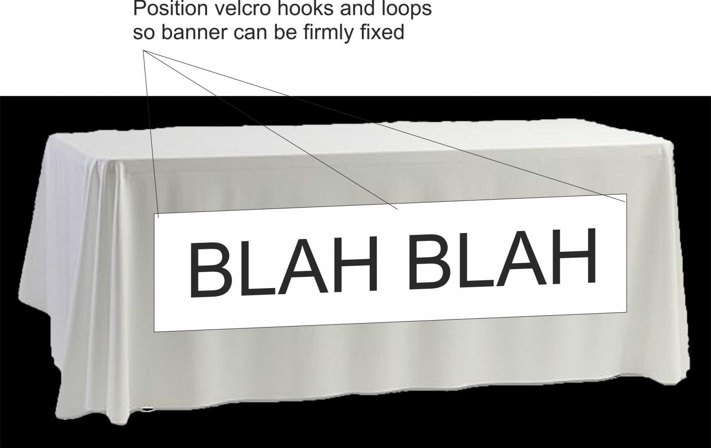

Find a table cloth that is perfect for her needs. Get some banners printed (either on vinyl or I think flag material would be better) and then using velco fixers you can "stick" them in the position required. Its not perfect but it could work quite easily. I can run a couple of flags for you for £20.00 (have quite a bit spare to get rid of
) have a look at the image to see what I mean....
I doubt if there is a sublimation material out there that is plastic in feel but can withstand 180 degree temperature so I would rule that out.
Personally I would look at printing this using a solvent wide format printer, if I had the width I would bang it out for you cheap, but I don't sorry
If price is the major issue then look at the following:
