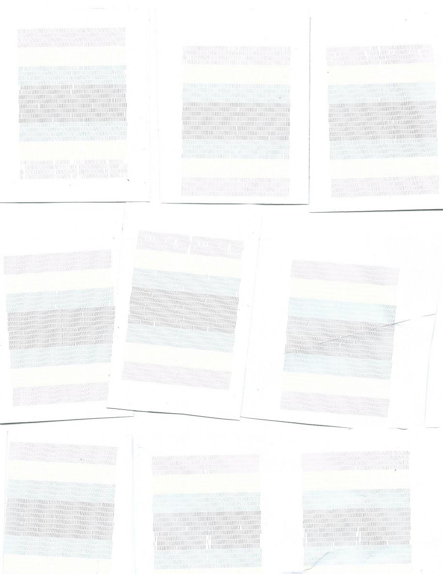

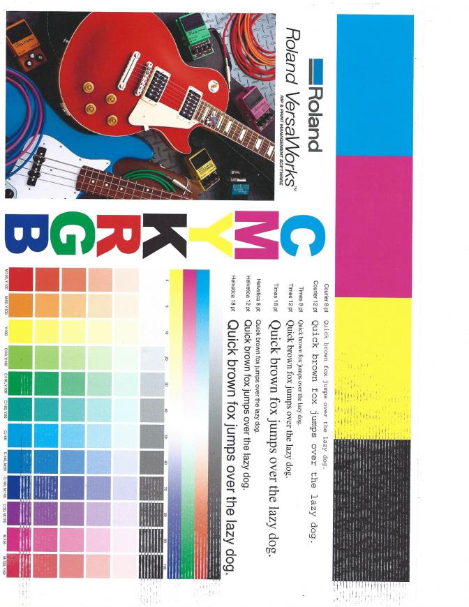

I bought a second hand Roland Versa Studio BN-20 a few weeks ago, I have only just got round to setting it up as I got married at last weekend so didn't have time to do it as soon as I got it. My problem is that I have run a nozzle check and it comes out not correct see images attached, I have done all the cleaning stages including a manual head clean and it's still not right. I have also printed a test image and it starts off fine then it looks as if something is scraping across it but I can't see anything see image attached. If anyone could shed some light on what this could be that would be great as I haven't got a clue.

Looks like you need to do the normal routine maintenance, clean round head you get dried ink build up there which then traps fluff and drags over image.
Probably good to change felt wiper, plastic wiper and scraper and gige capping station a real good clean and check rubber seal has not gone hard.

Fluff builds up at the back of the head and tricky to get at, can drag across work causing marks but not that bad. All as Arfermo says plus check your media isn't creased, bent or being raised up somehow towards the printheads path and touching as it goes over, should be a good clear gap all the way along the run.

Looks to me as though your paper is not holding flat because all the 'striping' is towards the bottom of the page and is page wide in it's effect. if it was fluff it would be over all areas so IMO you've suffered 'head striking' on paper that isn't flat.
Looking at the last two head prints...bottom middle and right..... there's a few 'mis-fires' but cleaning might sort that otherwise I don't think they will materially affect the print output.

I had a good look at it today, from the inside it looks as tho it had never been cleaned at all. Lot of dried old ink build up near the scrapper but the scrapper is in very good condition. Around the print head was some old dried up ink the I have removed with the correct cleaning stuff. It looked so much cleaner ran a normal head clean then a nozzle check but still miss fires, done a medium clean still the same results went for the powerful clean better results. So printed a test image and still the same results if not worse! I am wasting so much time, money, ink and media its a joke. I will post the pictures later of the latest test image
