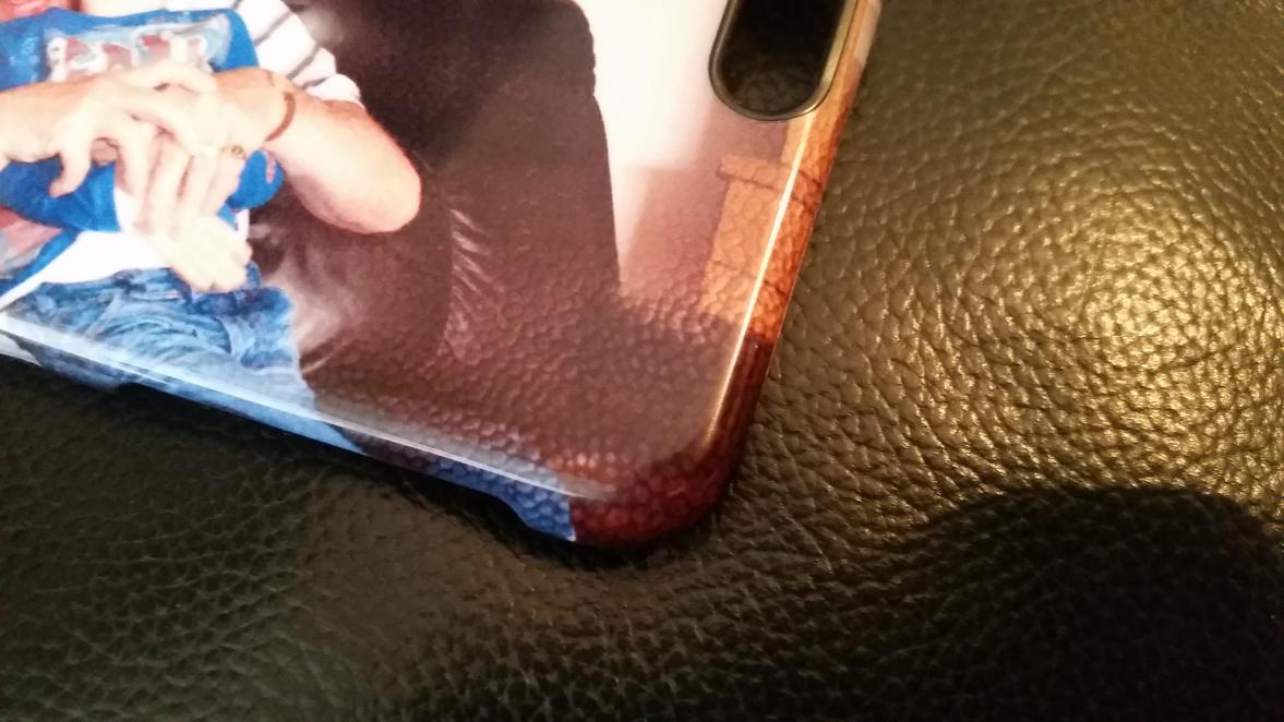

Post by gibo78 »
[ATTACH=CONFIG]3800[/ATTACH]
Looks mottled. Looked the same inside the film when removed
vB_ID:3800

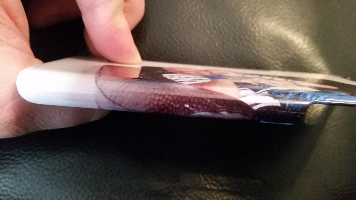

Post by gibo78 »
[ATTACH=CONFIG]3801[/ATTACH]
Can see better here. Transferred fine on other end of case
