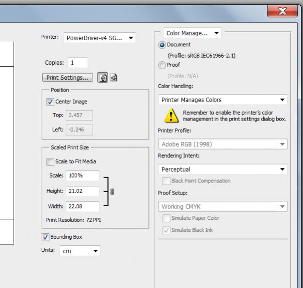

Photoshop & powerdriver works for me, a screen shot of my settings in P/S
- vB_ID:3634
- screenshot1.jpg (41.67 KiB) Viewed 34 times

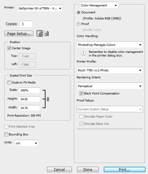

I run my Ricoh using an ICC profile so my photoshop print screen looks like this:

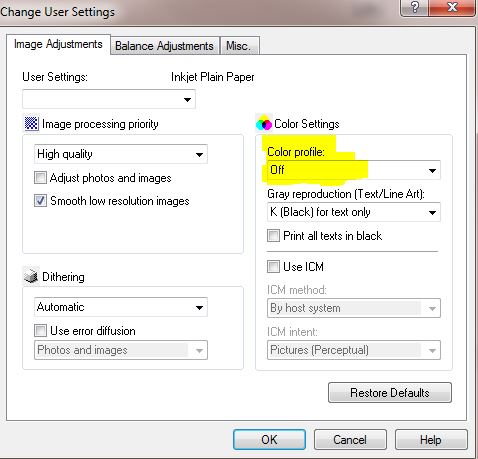

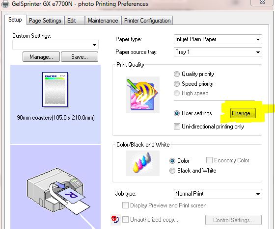

If you use an ICC profile as above, also change the printer preferences: color profile needs to be off.
Go printer preferences, choose user settings. then set "color profile" off.
Karen
Karen
- vB_ID:3636
- Capture.JPG (46.95 KiB) Viewed 34 times
- vB_ID:3635
- Capture3.JPG (45.69 KiB) Viewed 34 times

I have just done a test with powerdriver and the results on paper seem to be much much better, will know more when i do a press
Thanks for that info Karen I will make sure i have it set right pretty sure i have already but will run a double check and test

Checked the printer settings they were correct, looks like power driver has sorted it, will be pressing later so will update
