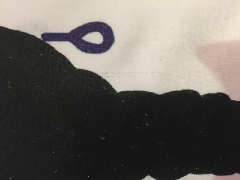

I just received the paper and did try to sublimate.
But even if I print at high speed on plain paper, ink are very wet and make some line when printing
vB_ID:3414
vB_ID:3414
Fichier 26-04-2015 12 52 27.jpg (35.54 KiB) Viewed 2757 times
Do you have some other recommendation ?
Re: sublimation on 100% cotton
is this with RICOH?
Isaac11
Posts: 27
Joined: 22 Apr 2015, 21:54
Post by Isaac11 »
Yes of course !
It's the SG7100DN
But I'm printing on Mac do you think this can change something ?
And I use the ICC Profil Subli2Cotton
I print from mac too and use same icc. Dont have this problem on my
