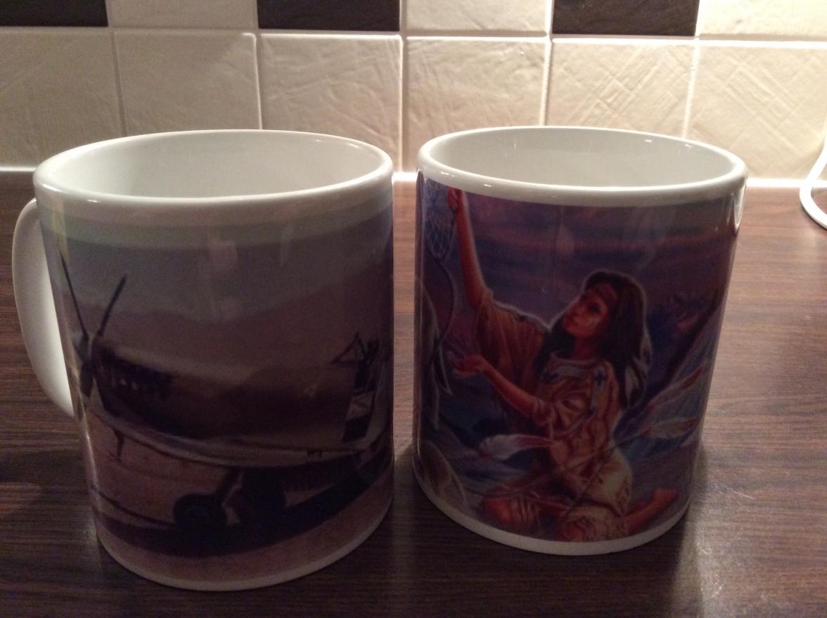

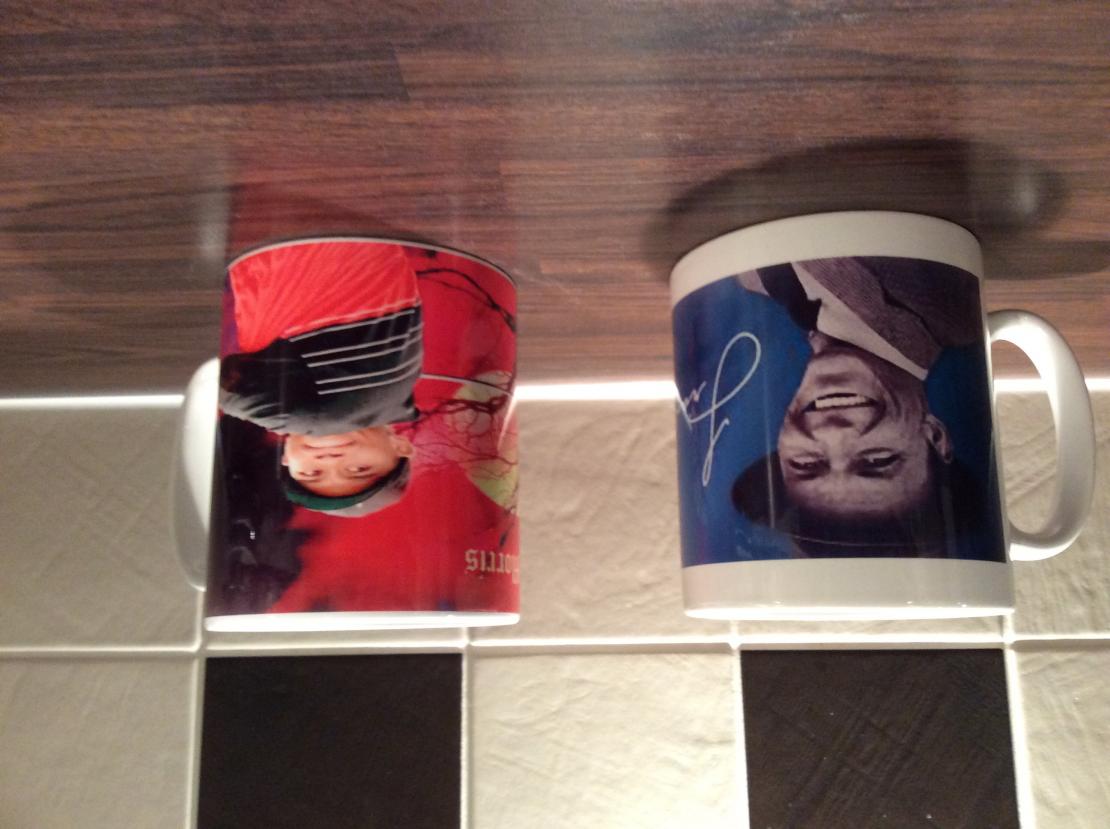

I have attached a photo of good mugs that I have. I have a new box of mugs so I will try them at the weekend to see if the mugs are the issue.
the image is upside down sorry .....

its the duff ones we need to see!
