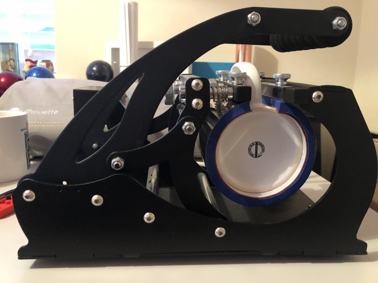

Take a side pic of the mug in the press with it closed.
The problem is you have a press which is most likely a clone.
When the handle gets to the halfway point you should start to feel a light pressure on the mug.
The spring loaded bolts should never be moved.
Re: MDP mug press. Read here owner review and pics.

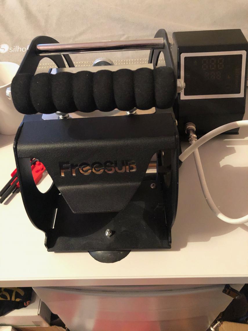

bear in mind its a FREESUB which I stated at the beginning, [ATTACH=CONFIG]6703[/ATTACH][ATTACH=CONFIG]6704[/ATTACH]yours probably doesn't say FREESUB.
heres x2 picture of side view and front.
That looks tight enough to me.Tony4415;148402 wrote:bear in mind its a FREESUB which I stated at the beginning, [ATTACH=CONFIG]6703[/ATTACH][ATTACH=CONFIG]6704[/ATTACH]yours probably doesn't say FREESUB.
Open the press tighten the thumbscrew and close it again.
dont get me wrong it needs to be a snug fit but not really tight fit.
as long as the mug doesn’t move in the press when closed.
