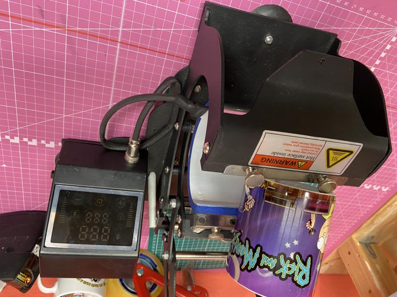

Pressing a mug:
  1. Switch on the press and when it reaches set temperature it will beep to say hey i'm ready.
  2. I insert a mug and close the press.
  3. As soon as the press is closed the timer will start to countdown.
  4. The insufferable non stop beeping will start when the timer reaches zero. (if you are using multiple presses this will annoy you)
  5. Remove mug from press after the 185 sec and dunk it in hot water and shake vigorously to remove the print.
  6. (If making more mugs just add mug to press as soon as i remove the first mug and close the press no waiting)

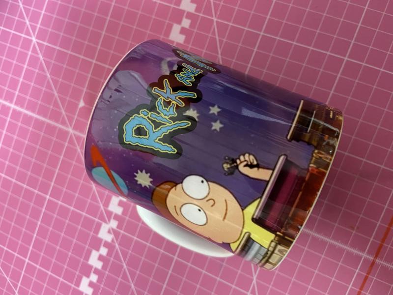

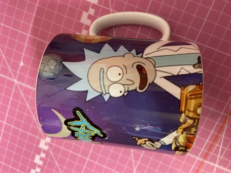

Can it do a full mug print:
Yes technically I do full mug prints allowing a gap for the handle Of course. (See images)

Yes But as all presses you will need a different element for each different size item.
How much pressure should I use:
Personally I use quite a bit of pressure to ensure a nice snug fit around the mug and paper.
When the handle reaches the half way point it’s starting to get a little tension so when fully closed it’s clamped in. This is down to personal preference though.

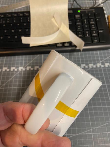

Taping the design:
I see so many people absolutely plastering their mugs and tumblers with kapton tape (heat tape) there's no need.
I add a small strip to each side of the mug (see below) and the pressure of the press itself holds the design in place so there is really no need for all that tape people.
