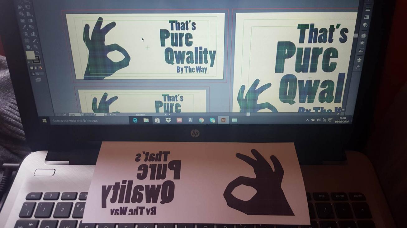

Re: Issues with Ricoh SG3100 DN
I had a lengthly webinar with Mags last night (cheers mate!) about my set up. Despite all his efforts i am STILL having colour issues, this has been the case from the very beginning.
I have attached a photo which shows the BMS precut paper appearing much darker than what is on my screen. when i sublimate onto the mug, i can barely make out the tartan that it looks nearly black. I can confirm that the tartan is part of an image, so will this be an issue when printing (out of gamut?)?
If so, then i really am wasting my time and would be best to stay away from tartan "images" altogether and work only with tartan vectors. Or, is there another way i can beef up the image so that it resembles what is on my screen. I have calibrated, and am working off both powerdriver and printer options (don't see any major difference in print) - i have also cranked my heat up by 10oc for another 30 seconds, no change in colour. For the record, i am printing out watercolour designs and they seem to be perfect, its the dark colours that are giving me the headache.

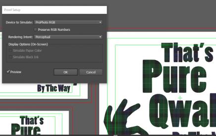

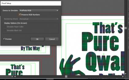

I have went into PROOF SETUP
Selected PRO-PHOTO RGB
Ticked "Preserve RGB colours" which completely changes the design colour scheme.... As it happens i really like the amended colour scheme (much more vibrant than when it is deselected, or i am using any other colour scheme (RGB, SRGB)
So... How so can i now configure and implement going forward so that when i print onto sublimation paper, my image comes out looking like PRO PHOTO RGB, or as close to it as can be? Because when i go to print (after selecting this option) my image still comes out dark - It is as if Illustrator is not accepting that i want to use ProPhoto.
I am not ready to give up on this yet, there HAS to be a solution:)
You can see the difference... I want to have the brighter printer off onto Sublimination paper (checked the Preserve RGB colours box)
Also, if i deselect the preview, then there is no change in colour when i select or delect "preserve RGB colours"
