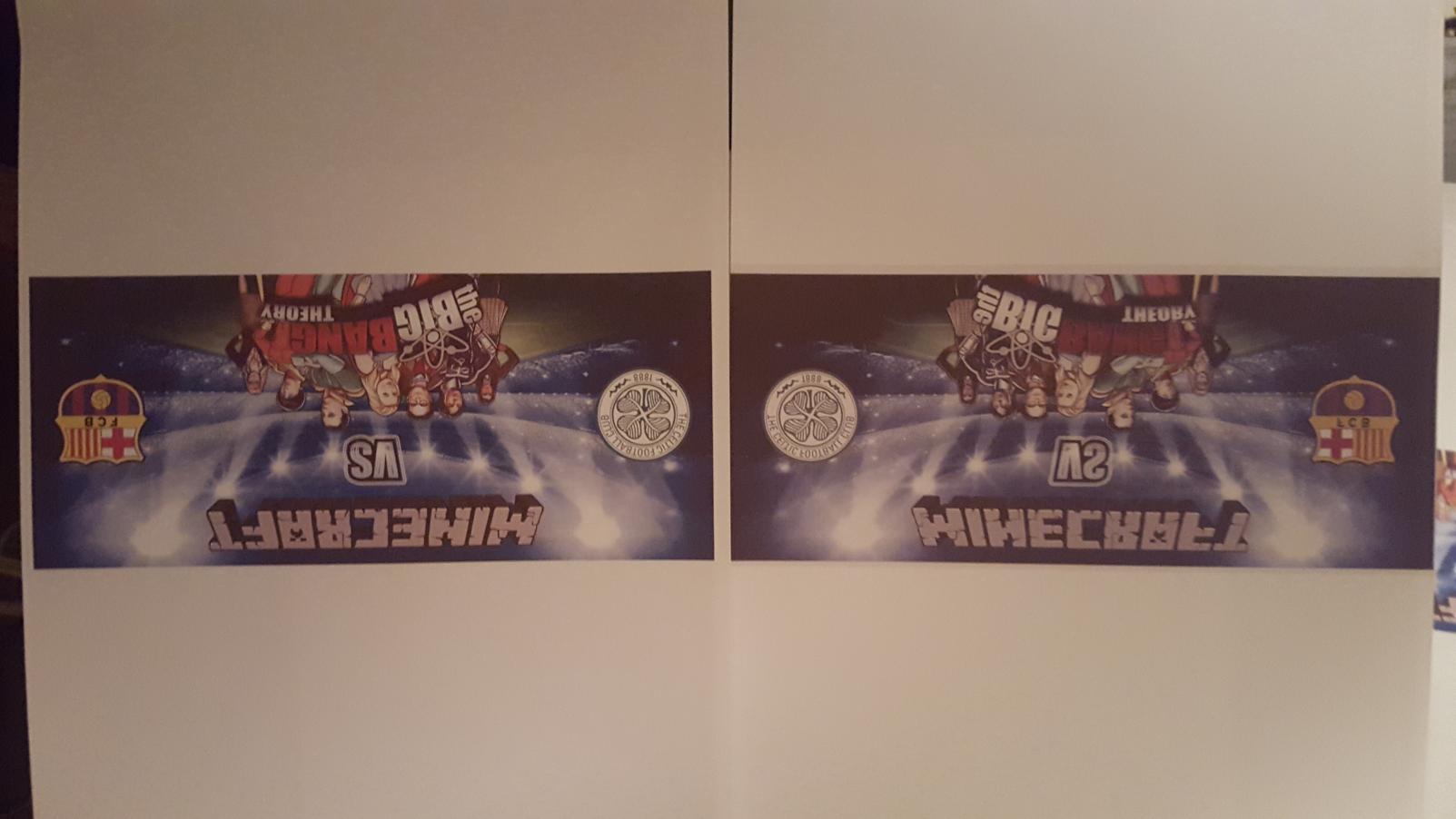

Re: Issues with Ricoh SG3100 DN
I have attached an image - the forward facing image is printing normally, the darker is using the powerdriver printing option
The print on the paper can have little correlation to the actual colours on the substrate once sublimated. So have you tried to press the paper yet onto the substrate? Also, what paper are you using?
Yes i have printed onto a mug and the output is that the reds are too dark (same as on reversed image i uploaded) - You can see on the normal forward facing print the reds are perfect. Using Truepix paper supplied by BMS.
Photoshop is going to do a better job of colour management than PowerDriver, you have very powerful professional software there, so use it at what it is good at. Get the Sawgrass ICC profiles for you printer, and use them.
Calibrate your screen, and use Photoshop in proofing mode, and you'll get a very good representation of what will be printed on the product - PowerDriver don't give you this.
