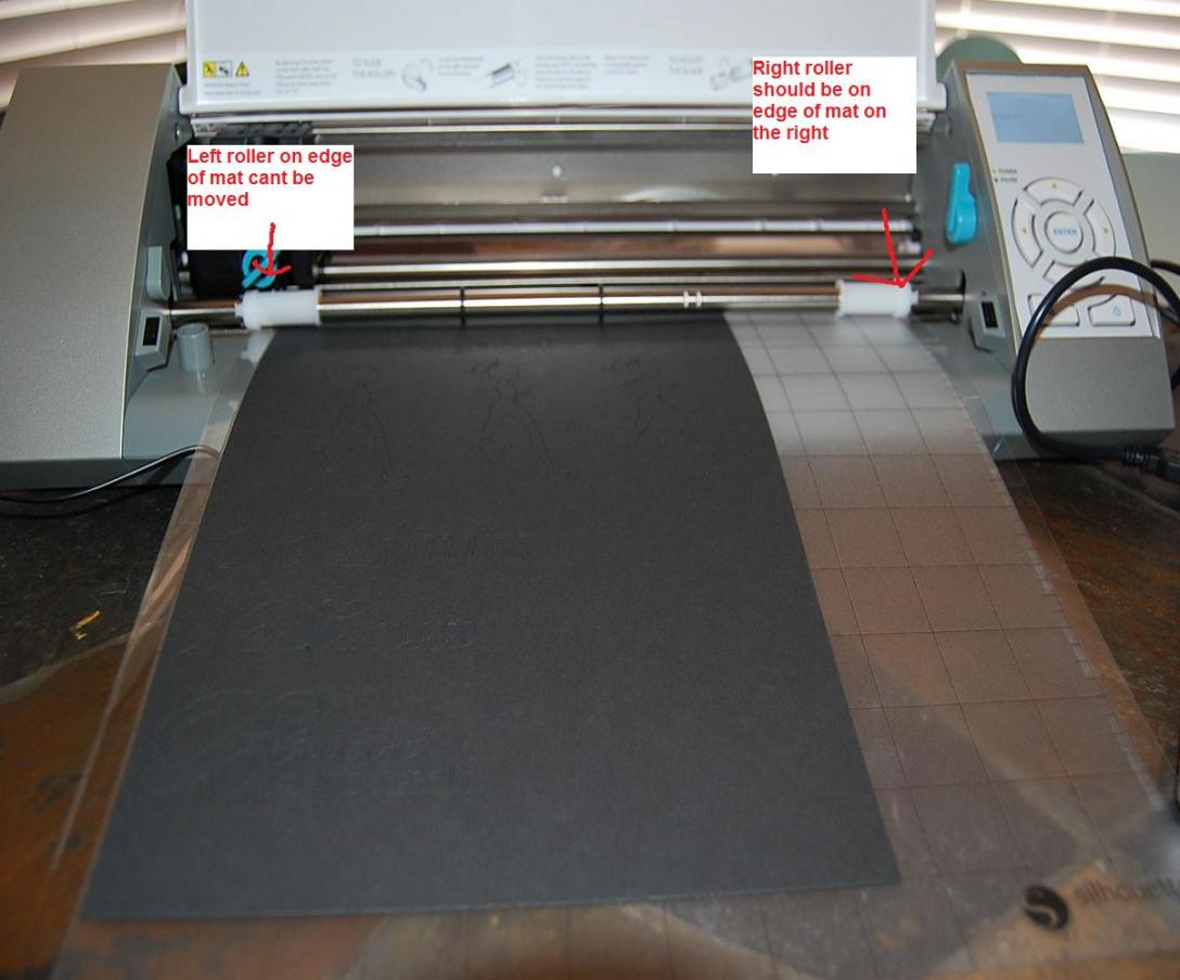

The short line on the left is where you line the mat up to, so that both rollers should not be on the sticky bit of the mat, also are the rollers in the groove
Mat in arrow first.
Cant think what else would cause this.
maybe a photo of how youve loaded the mat

My first roller is right near the cutter, and it was a a4 sheet of card the other was on the card, I'll set the machine up tomorrow and double check. Thanks again

the other roller (white) shouldnt be on the card. it should be on the edge of the mat

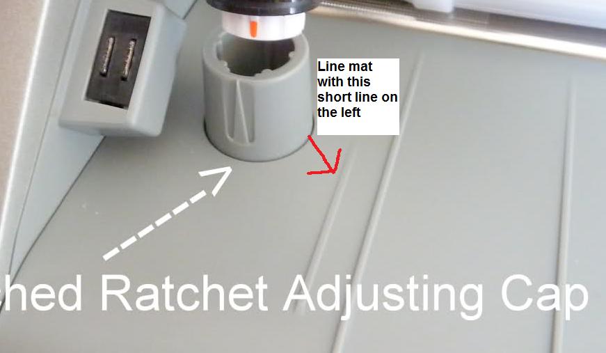

[ATTACH=CONFIG]1581[/ATTACH][ATTACH=CONFIG]1582[/ATTACH]
Im hoping you can see these enough to make out the text it is a 12 x 12 mat i just squidged the photo to fit it in.
Also mat and vinyl with no mat should be lined up with the short line on the left.

Looking at the pictures I'm placing the mat by the second line. I'm of to work in a hour so that will be my first thing on my list to try again lets hope that sort my problem

Thank you viccar I used the marks that you gave and hay presto no sliding, so not sure what's next, but back to reading the manual and learning what comes next
