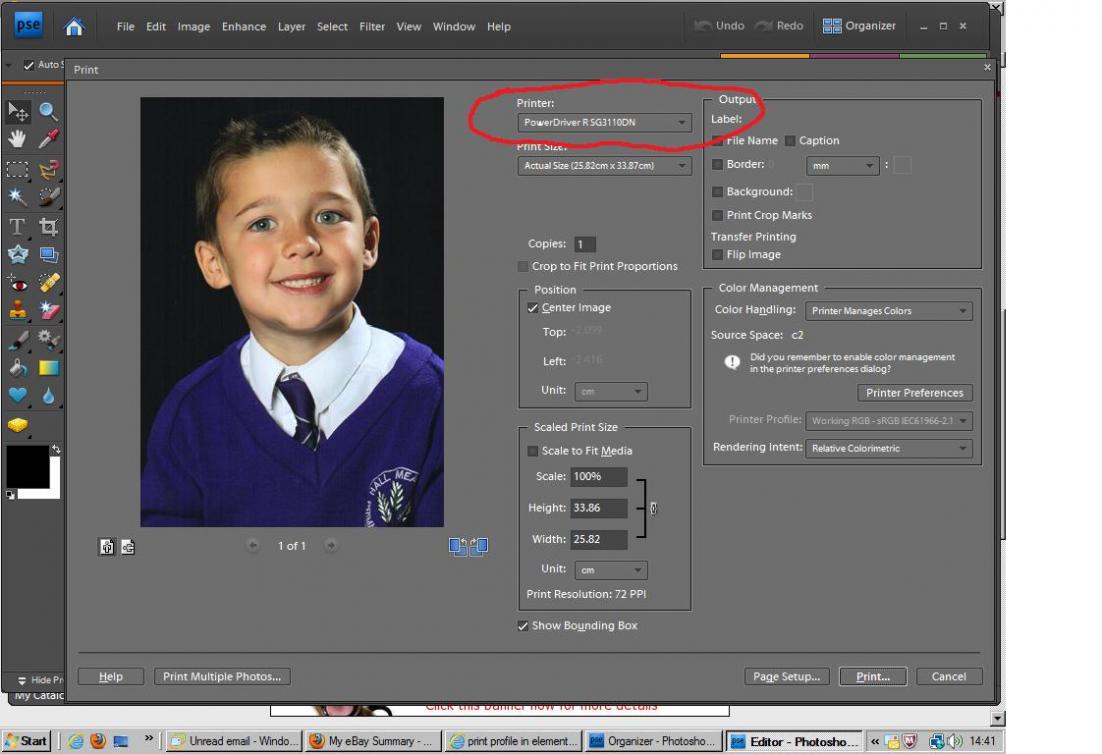

Im not sure on that steve, ive got elements 7, i know i followed instructions, then it didnt print quite right, so i asked on here and after advice i now just select print - powerdriver - then adjust settings in there if need be. Colours all good.
It is confusing because sawgrass say to follow steps.
Here is a screen shot of what mine looks like, not saying its right, but it works for me. Using the dropdown menu to select power driver
[ATTACH=CONFIG]1443[/ATTACH]
vB_ID:1443
vB_ID:1443

I you look closely to your screenshot you will see that you have set printer menage colors. If printer does tha then you cant chnge it. If you pick photoshop menage colors then you will get option of oicking any profile. But again... You use powerdriver so no need for changing an thing... Any way... Even if youreally want to change anything why would it be srgb??? Adobergb gives more true colors. With srgb you will get over saturated image.
