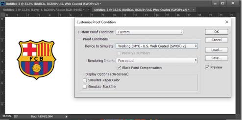

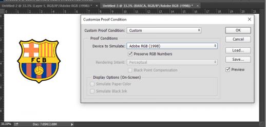

Hopefully this will help... You can see the colours on the CMYK are nice crisp and clear where as the Adobe is faded (when i go to print, my image comes out like shown in Adobe, even though in photoshop main screen it resembles the CMYK??.
The original image looks exactly like CMYK from the web however prints off like Adobe. How can i make the Adobe look like the CMYK colour scheme? What am i doing wrong?

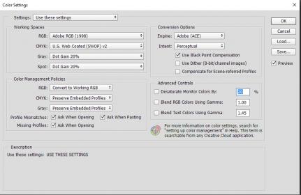

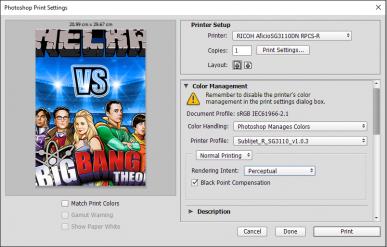

Additional settings i have configured and believe are correct.
If i select "working CMYK" to simulate in the image options, will this still send to the printer as an Adobe 1998 colour scheme? Or must i simulate only using Adobe 1998?
Nick
Nick
- vB_ID:3888
- Print Settings.jpg (20.86 KiB) Not viewed yet
- vB_ID:3887
- COLOUR SETTINGS.jpg (19.16 KiB) Not viewed yet

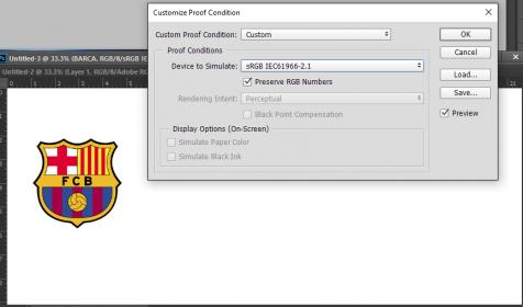

I think i may have solved the issue...
Would i be right in saying that if i select "SRGB iec 1966-2.1" in the proofing options, then the end print result should more or less match what i see on the screen? (providing i have my other print and colour settings set up correctly) - if i select Adobe 1998, the print ends up being too faded (as shown in example a few posts up)

I'm sure others have a great deal more knowledge than myself on this but you would need to convert your CMYK graphic to RGB first in Photoshop (before going anywhere near print options) and if the artwork is not as vibrant then you would have to get your designer to re-do the artwork in RGB mode. Everything printed onto paper is normally in CMYK but when it comes to sublimation then it needs to be in RGB.
