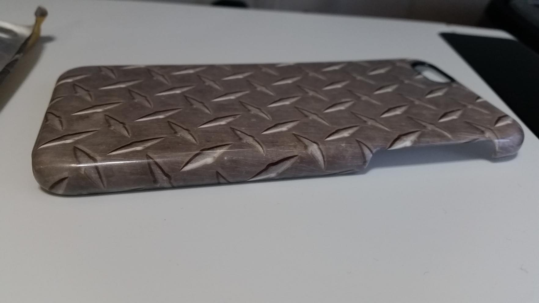

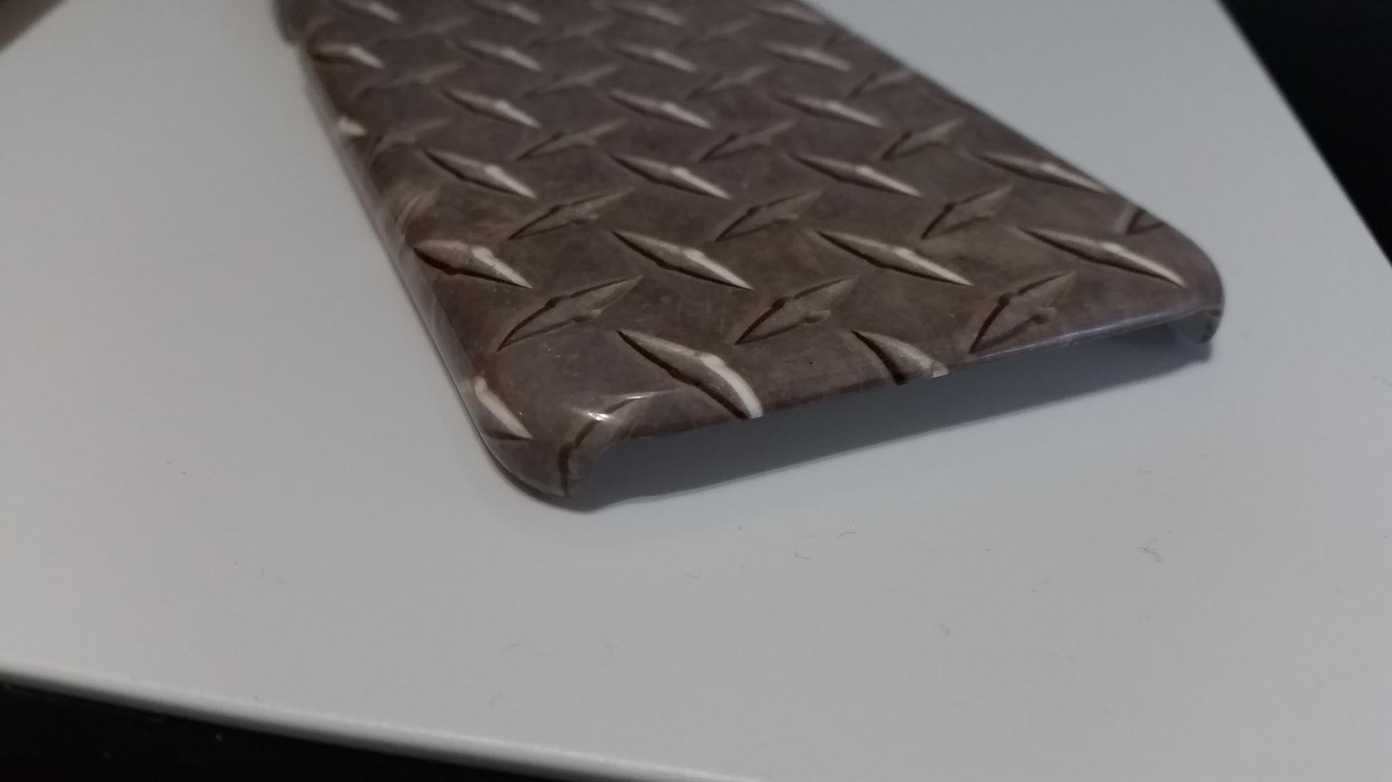

[ATTACH=CONFIG]3802[/ATTACH][ATTACH=CONFIG]3803[/ATTACH]
Inside film was all cracked on last one

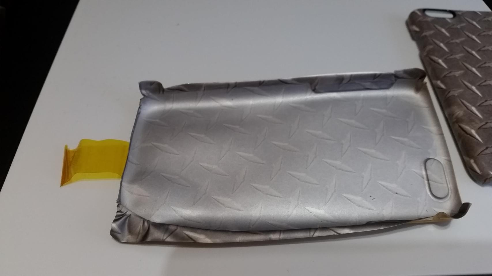

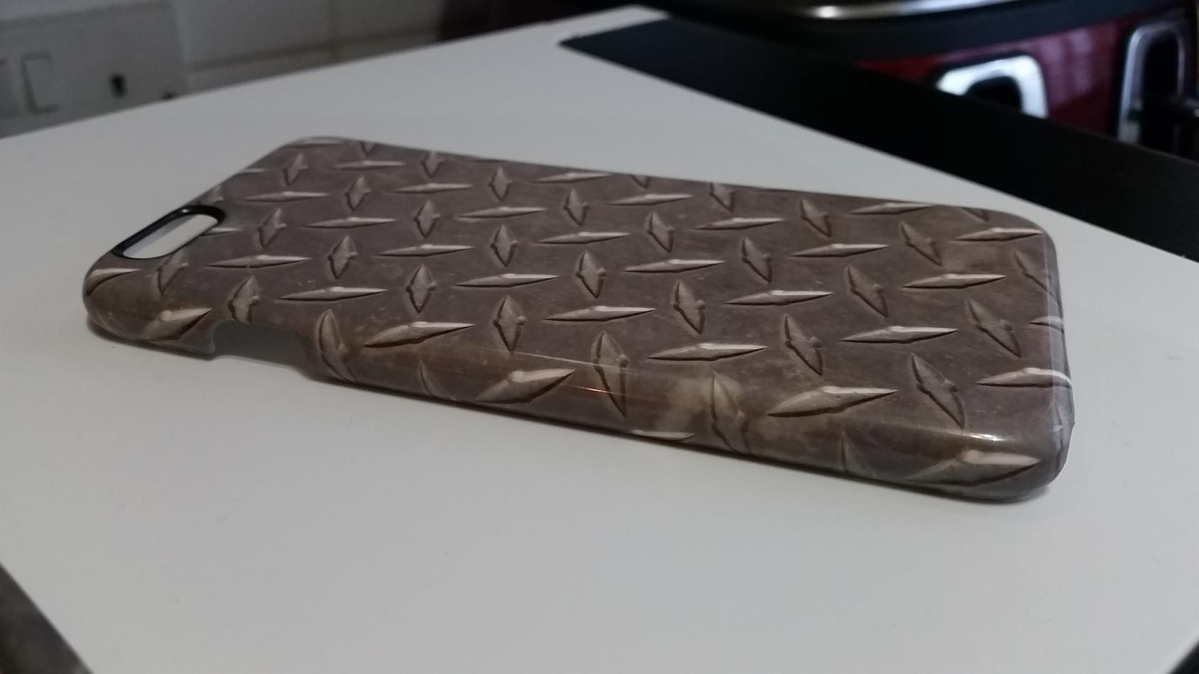

[ATTACH=CONFIG]3804[/ATTACH][ATTACH=CONFIG]3805[/ATTACH]
I only taped the short sides and trimmed close to just what was needed

I saw somewhere that you can adjust pressure on 3042 but that it's preset at factory so shouldn't really be touched. Anyway, this one came out nice but obviously need to keep repeating result to be sure

gibo78;107879 wrote:No I used gold and silver film as I have Ricoh sg-3110 printer. I know post above says can't use film in this oven but had another try today but covered with a silicone mat before the presses silicone diaphragm and didn't get any cracking at all and it came out nice. I'm using polyamide cases, 8 mins @ 140°C
that may be so my friend...but say you have 10 orders in, and you busy with other sub orders...so you are in hurry, you try n tell me you will get the placement of image perfect every time on that puck ?
not gonna happen buddy = wasted money = frustration = more coffee getting used :tongue:
but, you live and learn, we all did at one time or another
