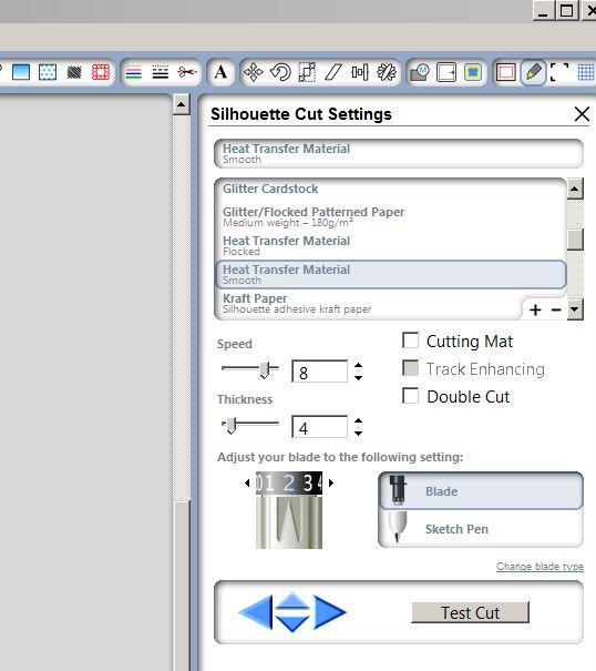

Hi use the tool in studio to give me, and adjust blade to what it says, its always a good starting point, if you are not sure use the test cut.
One thing i find is with heat vinyl it doesnt look like its been cut, until you start to weed it.
I use 8 speed 4 thickness and 2 blade but my blade is nearly 3 years old. so maybe a 1 with a new blade.
