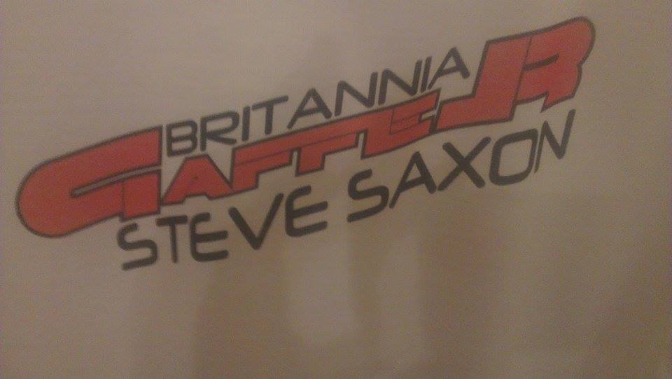

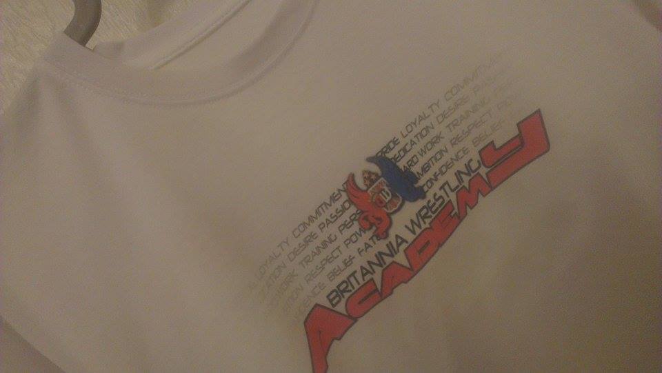

I've got a Chinese Press, Xpres T shirts and an Epson 235 (I know it's a low end printer), cooking at 350F (176 C) for 60 seconds.
The colours are coming out even (what a relief with a Chinese press), but slightly faded, ie not as red as I want, or as red as the printed page.
I've attached a couple of images of a shirt below.
If any of you could give me a little advice, I'd appreciate that! I have a feeling my temp might be too low, but I'd rather get some advice before I start experimenting on pricey blanks!

I'd lift the temp. to 190/200c and see if that makes a difference. Could well be the paper or inks you're using though. What paper? I'm guessing inks aren't Sawgrass approved so please don't name them here.

thomas, if you are not happy with that shirt, i suggest you use it to perfect your timing & temp, cut the shirt open, and then you will be able to press a lot more times on it - and you can use the sleeves for future "test runs"

Assuming that the fabric is 100% polyester..
Agree with above points of doing test prints on small sections of the fabric, and trying temps of 200 at 1 minute.
Fabric will print differently to mugs, and maybe you will want to have different bespoke ICC profiles created for the different substrates you will be printing to.

We always recommend a minimum of 35% polyester for a good result but of course 100% polyester is the best way to go. Start at 200c for 45 seconds and see what the results are like, if it is still a bit faded then try increasing the time in 10 seconds steps
The type of paper you are using can also have an impact on your results. As you are using an Epson printer you could try using a high release paper such as JetCol which is perfect for clothing and textiles. This paper does need some time to dry but will release more ink during the sublimation process which is what these items need.

I increased the temp to 400F (200C) for 55 seconds and I've got a really really rich, full colour image, I'll update with a picture later today
