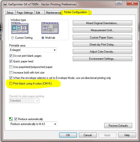

Is black printing using all four colours? & maybe the yellow is sublimating slightly differently.
My Ricoh printer preferences setup has an option to print black from the black cartridge only rather than using CMYK. Try setting the printer to use black only (if it isn't already) to see if it makes a difference.
[ATTACH=CONFIG]2468[/ATTACH]
