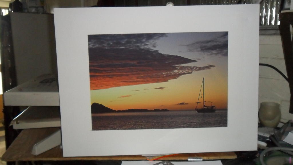

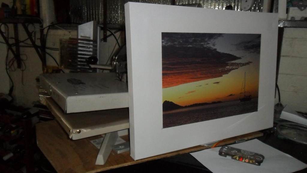

As is pretty obvious, I do sublimation mostly for fun and as a way to use some of my other equipment. So I do all the stuff that is not possible, like sublimating 100% cotton t-shirts.
Here's one of my sublimated prints into the normal cheap artist's canvases you can get at the 'dollar shops'. In this case the stretched canvas was $7.99 and I just prep the surface as if it is a cotton shirt, then print with sublimation paper and ink.
The surface of these canvases is already coated with acrylic gesso, but I treat mine with a spray on acrylic. Unlike tee-shirts though, with canvas it is not necessary (or in fact possible) to saturate the fibres. You just need enough polyester to sublimate into.
With a cotton shirt you need it so wet that you can wring the stuff out!
Here are a couple of pics of one canvas and a pic of the original photo, but there are some differences in colour due to lighting and because I don't have ICC profiles available for my printer. Having said that, I'm pretty happy with the Brother for dye sub.
