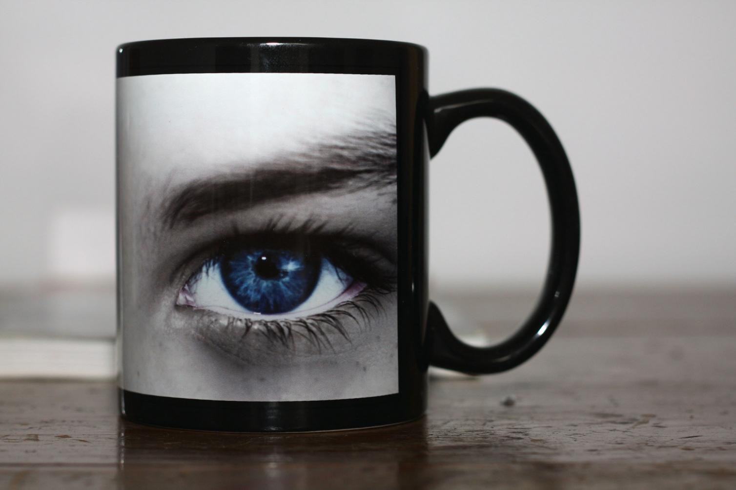

Looking to print a black panel mug, cant be wrong as I only have one.
Went on BMS and the sizes cannot be right?

The print area on my template is 84mm by 194mm, but if in doubt just measure it.
[ATTACH=CONFIG]1893[/ATTACH]
They can be stunning though.

Use a piece of masking tape, Wrap it round the mug and mark off the two edges. Add 2-3mm either side.
