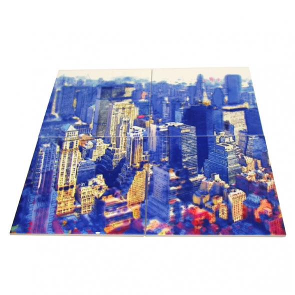

Oh and the tiles are put on thick felt so the print goes round the edges.

[ATTACH=CONFIG]1762[/ATTACH]Oh and the tiles are put on thick felt so the print goes round the edges.

swimwivsquid;70222 wrote:I tend to wrap the print around the tile taping the edges up. Takes a bit longer but seems to make a difference. Then with the tile face up and the print face down I put a silicon blanket over the whole thing and press at 200 degrees for 7 minutes. I've tried heating through the tile to the print but never been successful. Just recently did a 40x30 inch mural as a backsplash for a kichen in a villa out here in Grenada and it looked fab.
