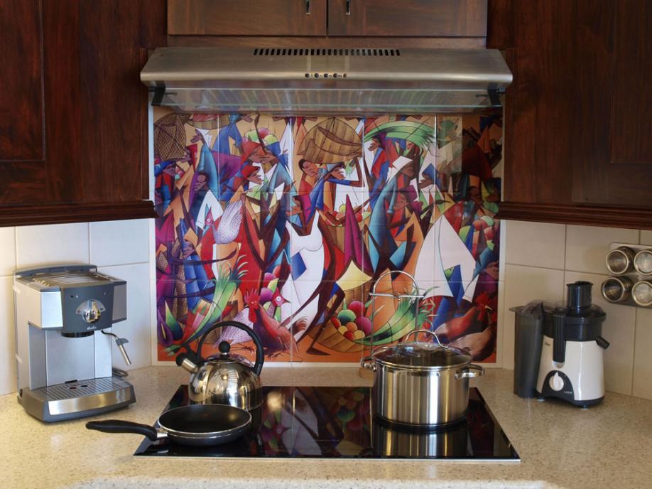

I tend to wrap the print around the tile taping the edges up. Takes a bit longer but seems to make a difference. Then with the tile face up and the print face down I put a silicon blanket over the whole thing and press at 200 degrees for 7 minutes. I've tried heating through the tile to the print but never been successful. Just recently did a 40x30 inch mural as a backsplash for a kichen in a villa out here in Grenada and it looked fab.

Richard, that looks amazing. :biggrin:

Post by jennywren »
Love what you have done. That is mega smart, time to give your self a pat on the backl

Thank you Jenny and Ian. It was a great project to work on.Sort of jobs we like.

Errr WOW !!

WOW, WOW, WOW, WOW. I'm jealous :rolleyes:

I do my tiles with the tile print face down at 200C for 4 minutes, works perfectly for me. I'm hoping to open a bar soon and looking at that picture, I think I might just print myself some before I leave the business!!! Good idea!
