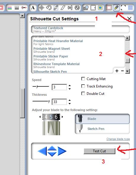

[ATTACH=CONFIG]1583[/ATTACH]
1. select cut settings
2. choose nearest product
2a lol i forgot arrow but dont forget to change the blade depth
3. use the test cut.
Use the test cut (if your using studio) then you dont waste anything.
On cut setting in studio you can make your own custom setting, so when you do something new and find the right setting you can name it and then all your settings will be there each time you use it.
Ive never had to use above a 5 yet and thats on very thick rhinestone material.
