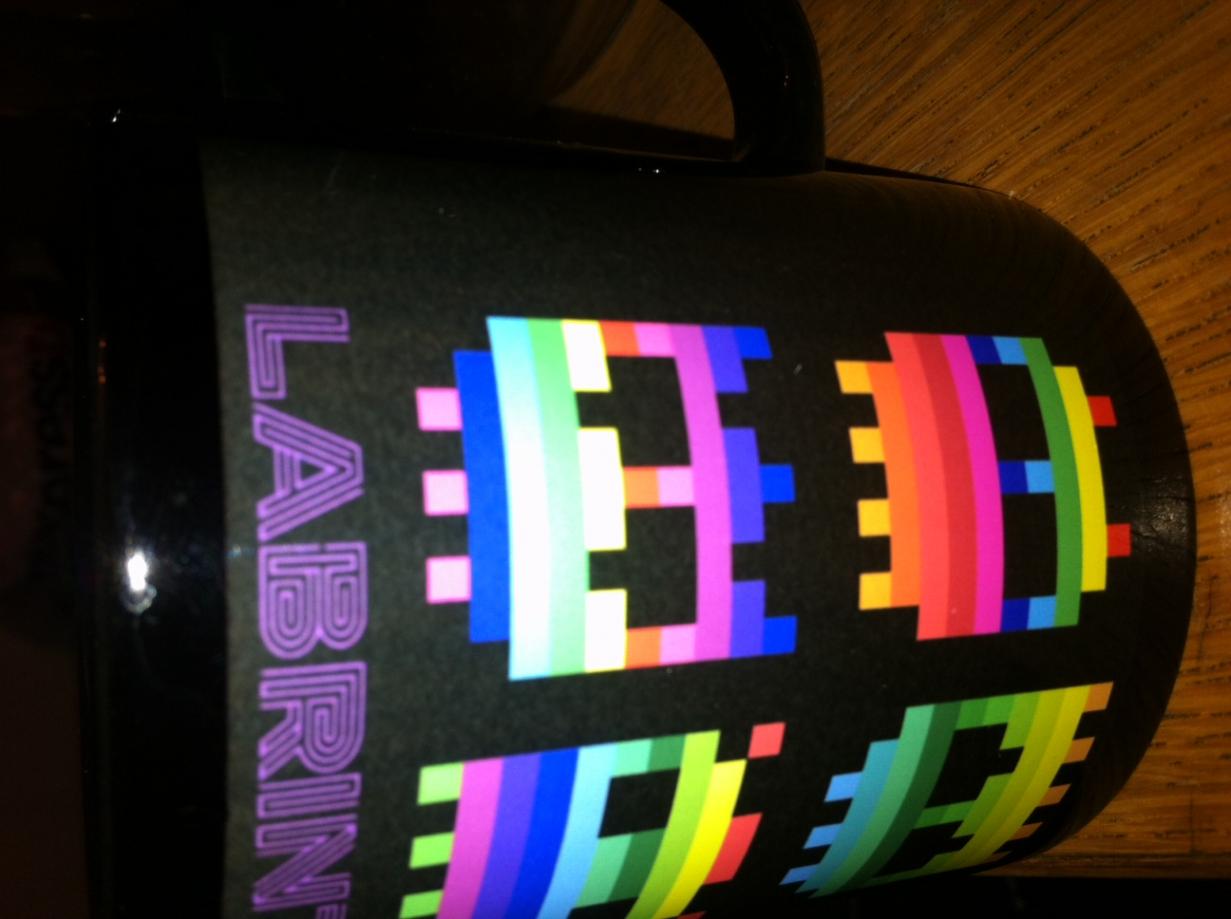

I have a feeling that the mugs are just not as good as anyone would expect. I need to print a logo on the mug and then fill the spare white area with a black to blend in with the actual mug. I know I am not going to get it exact as you can not do this when matching blacks that have been printed two different ways, however I would have expected them to be better than what they are. I can clearly see the difference from half a meter away under awful office lighting.
Think I am going to have to step up the penny saving for the new white laser printing system from TMT. Although they are saying that they are not dishwasher proof, I think I have an idea that will make them so.
Attached is an image (yes I did print it upside down grrrr!) of the result. Not great but will have to do.

Well it looks to me like they are better suited for photographic images than artwork on black background.
Re: Black Mugs With White Panel
I think you are right WDR but thought I would see if anyone had any useful tips.
From what is being said I think the only tip is don't sell them
