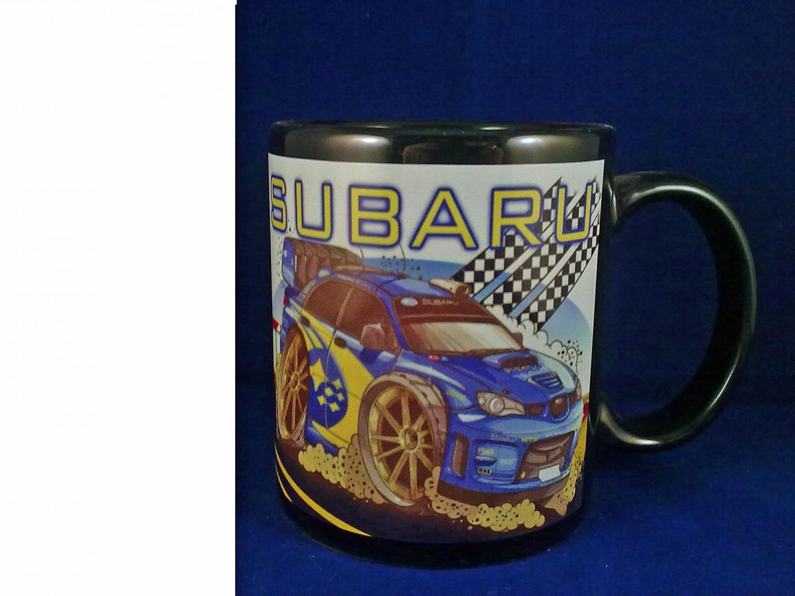

I've printed photos and Koolart images @180 for 180 sec with no problems.
Re: Black Mugs With White Panel
Hi Reg
Do you have a picture of one?
In particular I am interested in how close you get the blacks to match?

This is the only picture I have not a lot of black in it. [ATTACH=CONFIG]1216[/ATTACH]
vB_ID:1216
vB_ID:1216
subaru black.jpg (88.39 KiB) Viewed 4 times

That would solve the problem of matching the black, might have to rethink logo design
