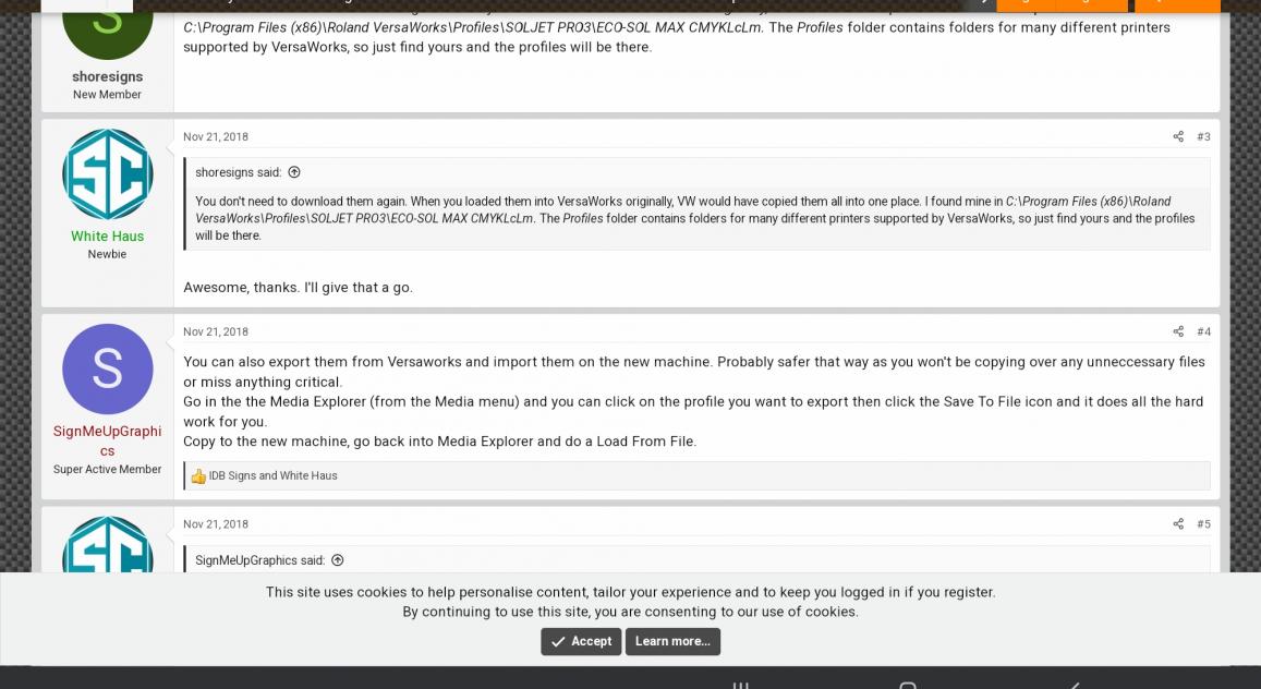

Re: Help VW queue settings
Do either of these answers help?
Tried these but sadly it’s not saving the print queue settings.AGS;152660 wrote:Do either of these answers help?
