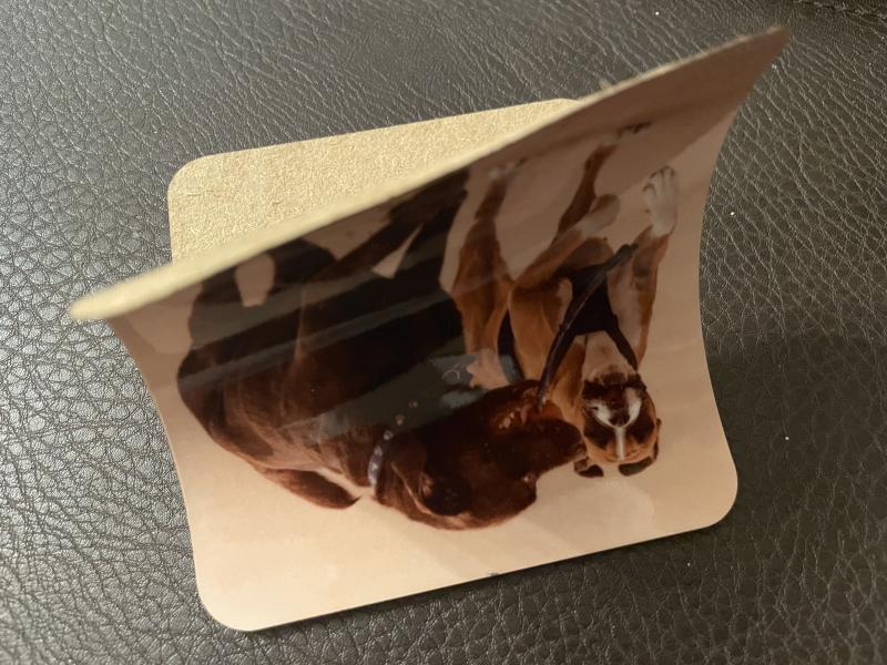

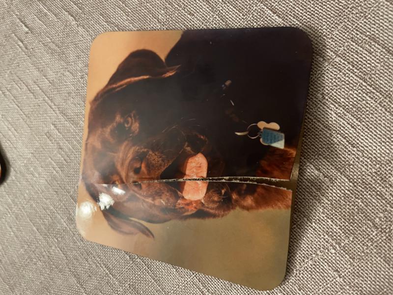

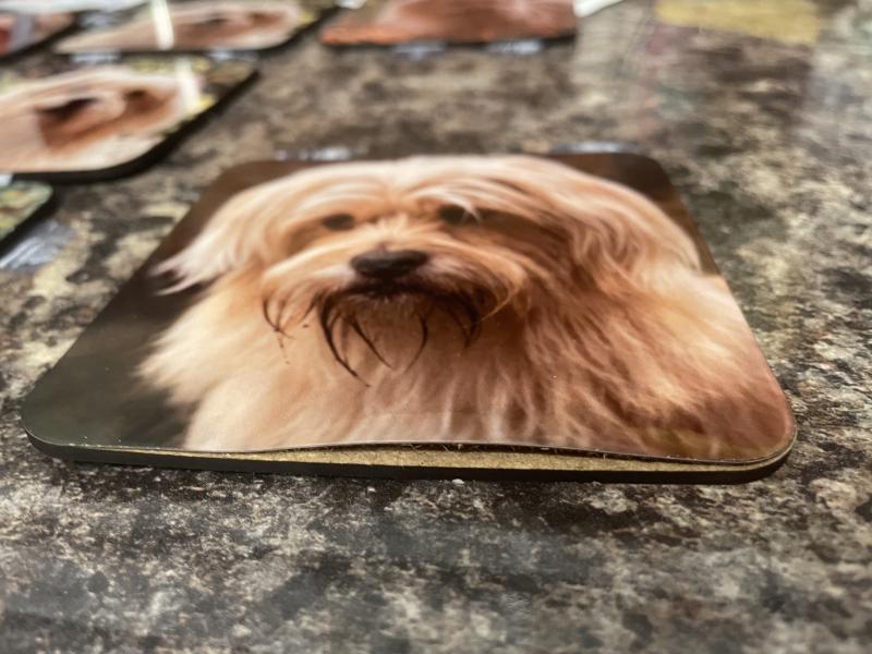

Hi I’m new to sublimation. It’s my first week using my setup (epson sc-f500 and galaxy swing press). Lots of hiccups, but most I think are teething problems and getting used to the equipment and experimenting.
However I seem to be having a major issue with hardboard coasters. The tops are peeling off, splitting and lifting. I have pressed the coasters with the sublimation paper and artwork to the top of the press and every coaster I have done results in some form of lifting despite using suppliers recommended heat temps, times and pressures.
what could be causing this? I’m out of ideas to try. 😞. Many thanks in advanced.

Terrible coasters are your problem. Grab some unisub ones and do at 180c for 85s.
Orangeoctopus
Posts: 24
Joined: 02 May 2022, 13:25
Re: *new to sublimation* Hardboard coaster problems
Post by Orangeoctopus »
I've given up on MDF coasters due to warping, now switched to aluminium coasters
