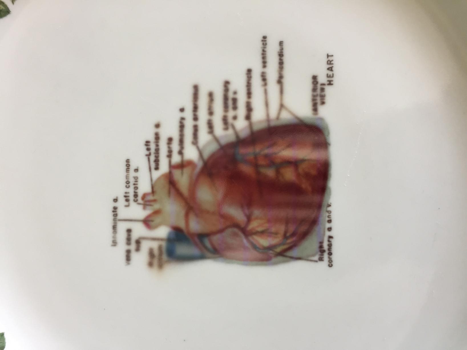

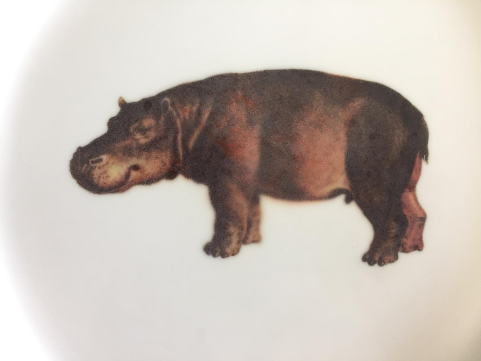

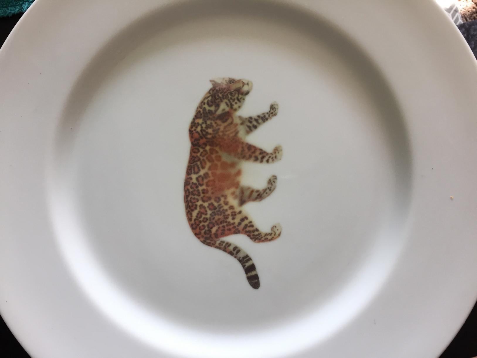

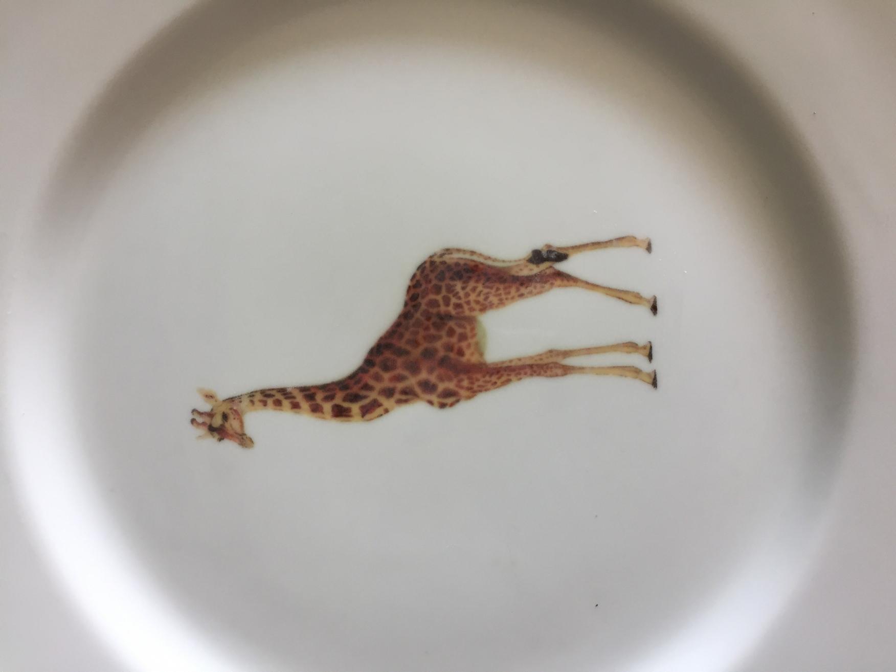

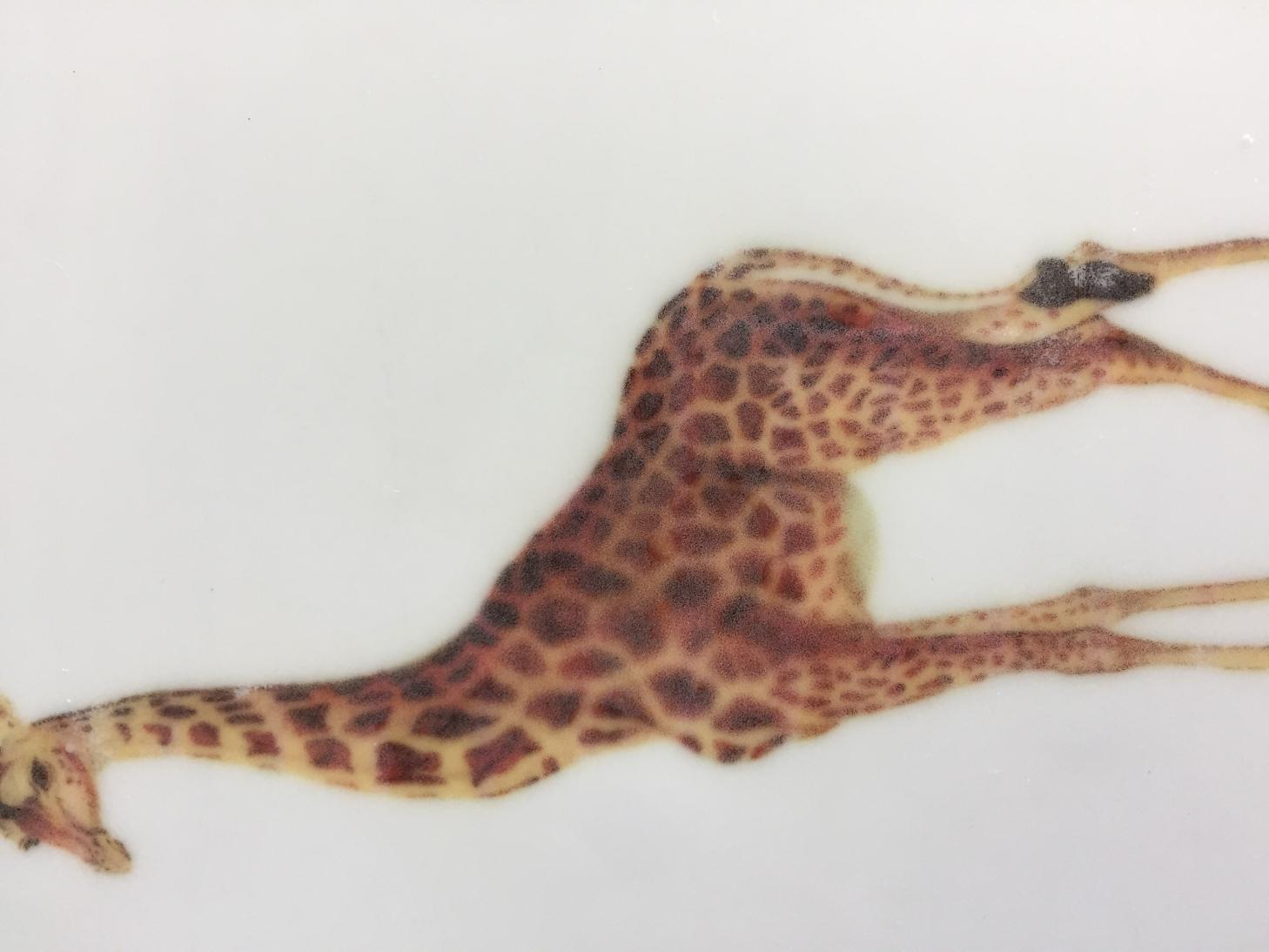

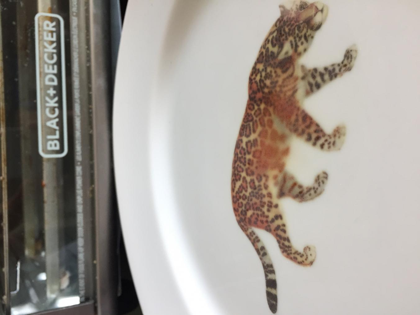

Then I sublimate the plates. I've tried 240sec (the hippo), 220sec, 200sec (the leopard), 180 sec(giraffe), 160sec (the heart). I've had the best results with 180 seconds (the giraffe).
However, most of the plates have a small depression in the middle of the plate, directly in the center. It looks like most of my plates are blurry in the very center of the plate where the depression is. Moreover, most of my plates are not transferring very well at the very edges of the image I am trying to sublimate.

If there is a small depression in the middle of your plates I would that your flat heat press platen isn't making full contact which would cause this.
I assume you're using a plate press platen?
It's not normally necessary to pre heat anything unless it has possible moisture. Have you tried without? Unless this is specific to your coating which I wouldn't know.

Thanks, yes it is with a plate press platen. I have tried sublimation without pre-heating the plates, but I had worse results.
Is there a technique you know of that would allow me to get full contact with a plate press platen if the plates have a small depression in the center of the plates? I've seen some people put rubber silicon baking sheets between the plate press platen and the plates, but I am not sure if that will solve my problem.

I've done similar on mug bases that were slightly concave, adding small pieces of rubber sheet. Problem is you have to up the temp and/or time and the rest of the image may suffer as a result.
My immediate thoughts are that you need to be using perfectcly flat plates but maybe someone else can offer a solution.
They 'may' work with shrink in an oven as this take up all uneveness.

I use a bit of 1mm silicone sheet it helps with the uneven surface of the plate also gives slightly more even heat distribution
But I have to add about 90 seconds to the time
