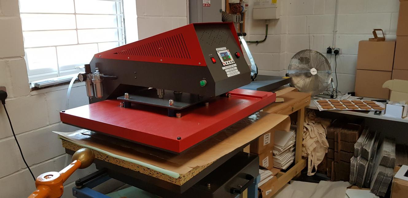

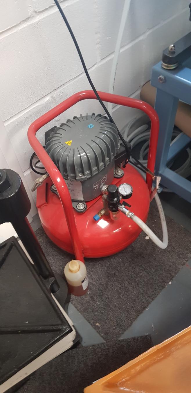

Re: Nova-chrome A1 Pneumatic Heat Press 105 x 75cm what sort of a Compressor needed
The compressor we use is "Clarke Shhh Air 50/24 Quiet Run Compressor"
https://www.machinemart.co.uk/p/quiet-r ... essor-4-2/
I must admit we found a second hand one being sold locally for £150. Thankfully we have an air compressor company two doors up who fitted it in exchange for some mugs
It is silent most of the time (as it is not being used) and when the press needs air it is very quiet. Basically it only fills the press with air automatically when needed and comes on for only say 10-15 seconds.
We actually bought the press a year before we could use it as needed to get double doors fitted to our business unit to get the beast in. Although not bought from Nova Chrome we did buy their metal frame which I TOTALLY recommend as well.
[ATTACH=CONFIG]6728[/ATTACH]
[ATTACH=CONFIG]6729[/ATTACH]
Thanks Olli ,
Thanks for the pictures, We have turned the machine on the other way round to get it through the door , and person sold this gave us a wooden table slimier to the metal one goes with and its actually on it now . He had a 32A socket for this and we are going to get it done now only the compressor is missing. I have a offer for a Bambi slimier looking one 50L etc for £275 in brand new condition (150 miles away lol) and I can see Hyundai ones going at £280 brand new with 2 yeas warranty . Will buy one of them .thanks again
