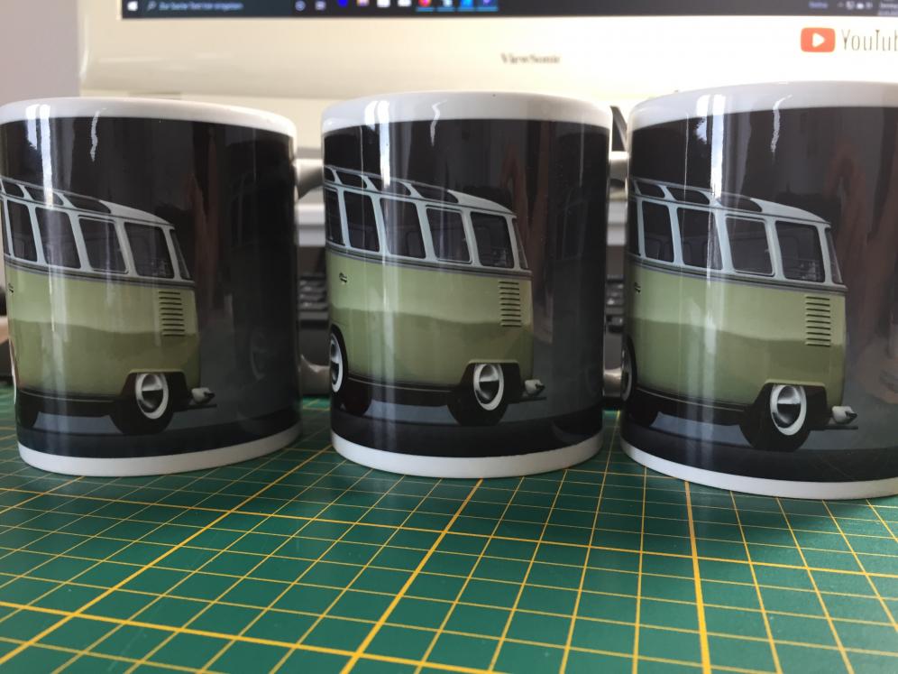

I experimented alot with different temperature settings today and i could get rid of the slight fading at the bottom, cracking! However i think an oven is superior to a mug press because if you look very closely on your sublimated image in a certain angle you can actually see the pattern of the heating tubes, i think this is the downside of a mug press, it can not distribute the heat as even as an oven. I tested another 4 mugs today and i think i have found my setting and will stop from there and try the ofen next week.
Here are the results, one mug had a bad print line because i cuttet the paper not properly. This can be solved with a white borderline to your image, i havent figured out how you can cut images on affinity designer. On the left is the mug from yesterday with the faded bottom. The next two mugs were all without fading, the different settings of the two mugs had no influence on the image at all, strange. [ATTACH=CONFIG]6065[/ATTACH]

I realise this is an older post. I always let the ink dry fully before applying the designs to our mugs, if you are getting fading, there is a good chance that the pressure you are using isn't even or enough. You can try pushing on the handle of the press to increase the pressure while its sublimating to see if it improves the sharpness and coverage. If it does increase your pressure permanently. You can check the pressure of your mug press by sticking pieces of paper strips all around the edges of your mug while clamped and see if you can pull them out in various places?

You shouldn't need excess pressure to print, as long as the transfer has a good tight fit its the heat and time. Too much pressure will result in element marks in your print.
Fading is most often down to the mug not being straight.
