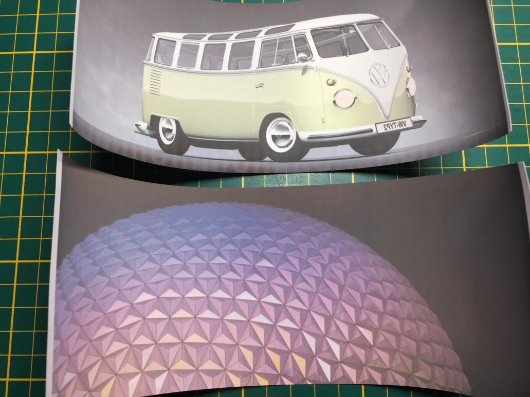

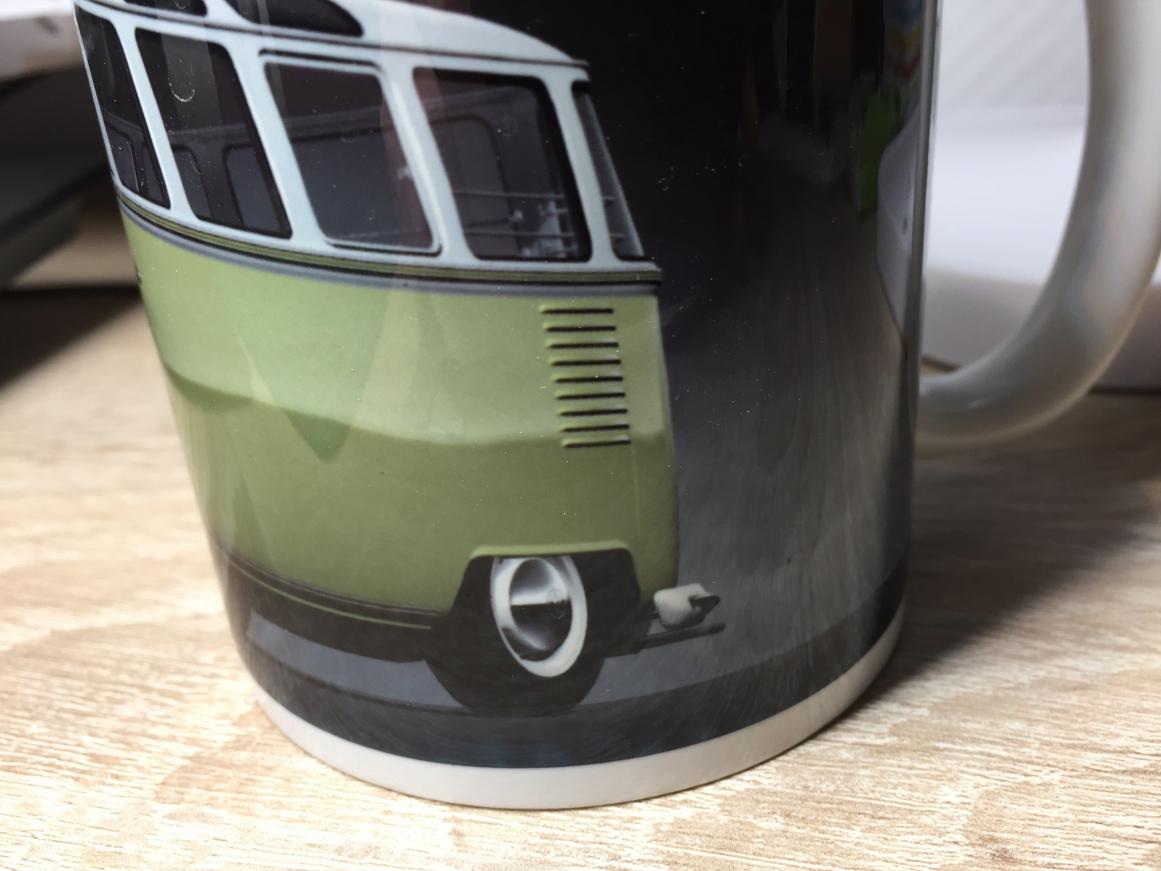

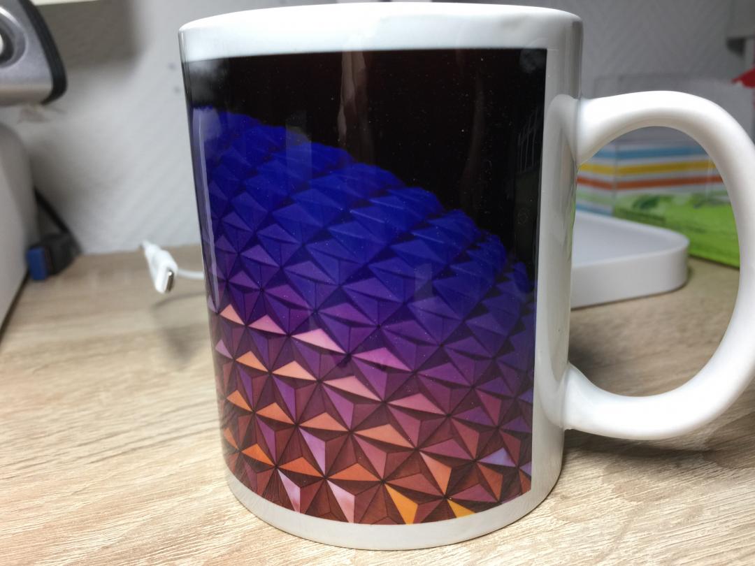

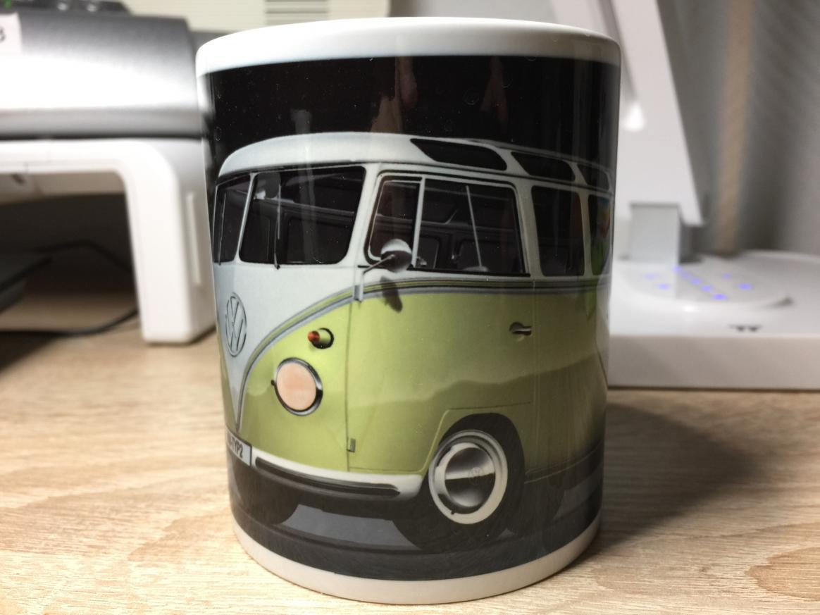

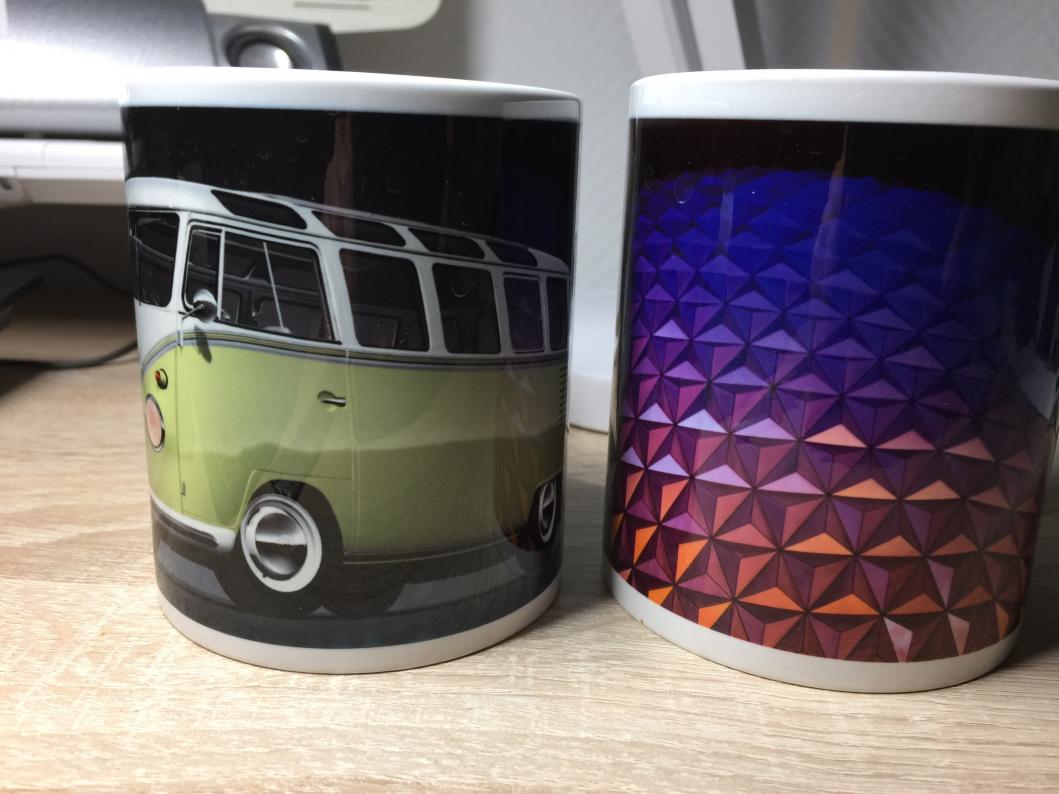

Today i did my first two mugs with the microtec machine and i gained the first expierence with mug pressing and sublimation in general because i only sublimeted two pieces of cotton before. What i can tell is that the mug press seems a bit on the weaker side because the first press i did was at 180 degree Celsius and since this press has no idle time i started my own timer with 70 secs after it reached 180C which took ages and in general the press needed 257 seconds in complete. I had no fading on my first mug but since the time sounded crazy long to me and the paper was already a bit brownish i decided to go for a different setting on my next mug. This time i went for 190C /180 seconds.
I have like 7 time settings gathered from alot of youtube videos and i want to check them all. The 190C - 180secs setting is actually used in many videos of the freesub ST-130 press. However the result was slight fading at the bottom, the top was good and the blacks were better compared to the first one which i think was maybe a tiny bit brownish but hard to tell.
What i can also tell is that machine smells like hell, i could hardly breath, an extremely chemical smell and i felt dizzy after it. I am not sure how i can counter the fading at the bottom, i will test another 3-4 mugs and then try the halogen oven. I dipped both mugs in boiling water to cool them down smoothly.
So overall this wasnt the result i hoped for but i am pleased with the colors, saturation, sharpness and black levels, especially the 2nd mug had good blacks. The only problem is the fading at the bottom. So maybe i just need to go a little bit longer, lets say 190C and 200 seconds or 220 or i should try 180C and 220 seconds. I just feel the machine is weak, maybe it has a bug in the software because realized that the temperature always stops 3 degrees before your target temperature you set which is strange, its like it pauses for 20 seconds and then heat up again, i can see that the heat symbol is blinking when this happends.

I heat my press up to 180 with a blank mug in then remove the blank and replace with the wrapped mug. The temp immediately drops back into the 150 to 160 range so I let it come back up to 180 before triggering the timer, which I have set at 200 secs.
Fumes are common with a new press and will die off after you've used it for a while.
