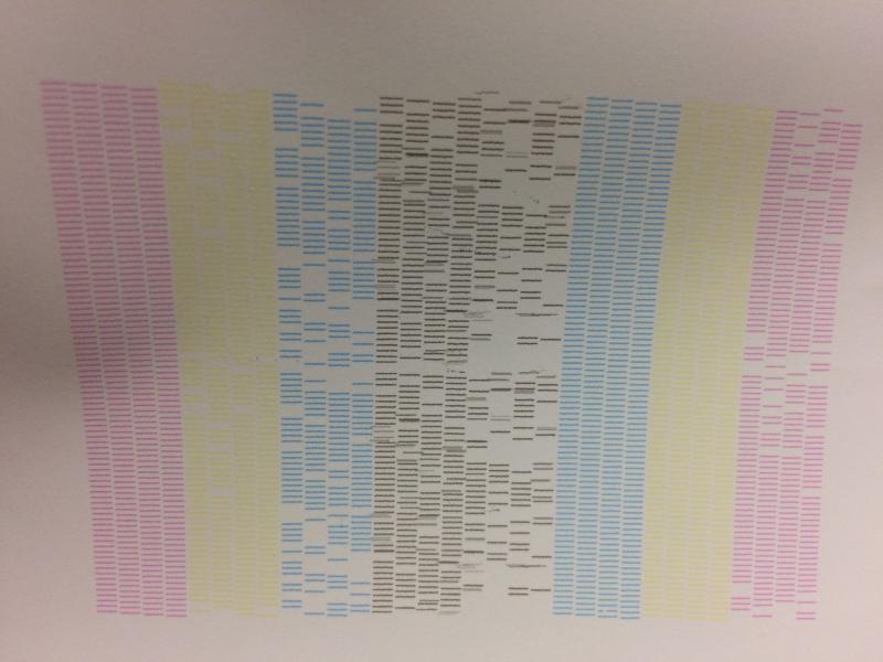

Hi
I've got quite a lot of gaps when I do a nozzle check print and have done 3 powerful cleans and that hasn't helped. I see there is an option for a head wash, where you use the dummy cartridges etc. I've never done this. I bought the printer used about 3 or 4 years ago i think. Should I try doing this? it doesn't sound like much is in the cleaning cartridge though.
Also there is a lot of black ink where the wiper etc is, where you clean. looks like it's leaked or something. Is it suppose to be like this? I think it's been like this since not long after I bought it, so didn't think anything of it.
Thanks for your help

has the wiper or felt pad ever been changed? If not a good thing to do and you should clean it regularly around the capping station, edge of head, scrapper etc with swabs and cleaner. Sometimes after a clean I run solid colours in CMYK as a print test to get things firing through well as sometimes the test print looks worse after running one of those cleaning cycles for some reason but running a job as described gets a better result if the test is done after. Might need a bit more of a service of course but thats a few things there you can do before running cleaner through (which ive never done either)

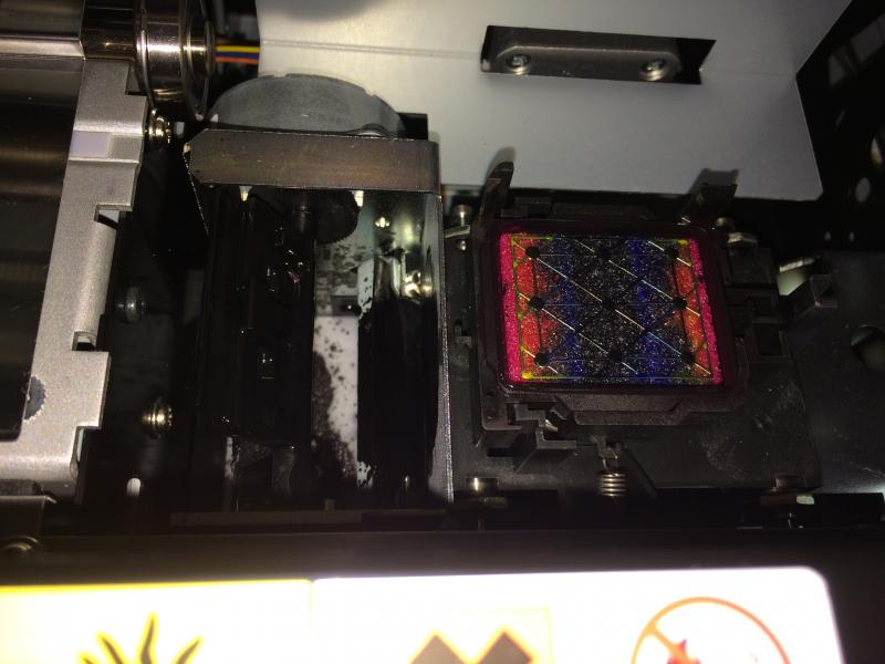

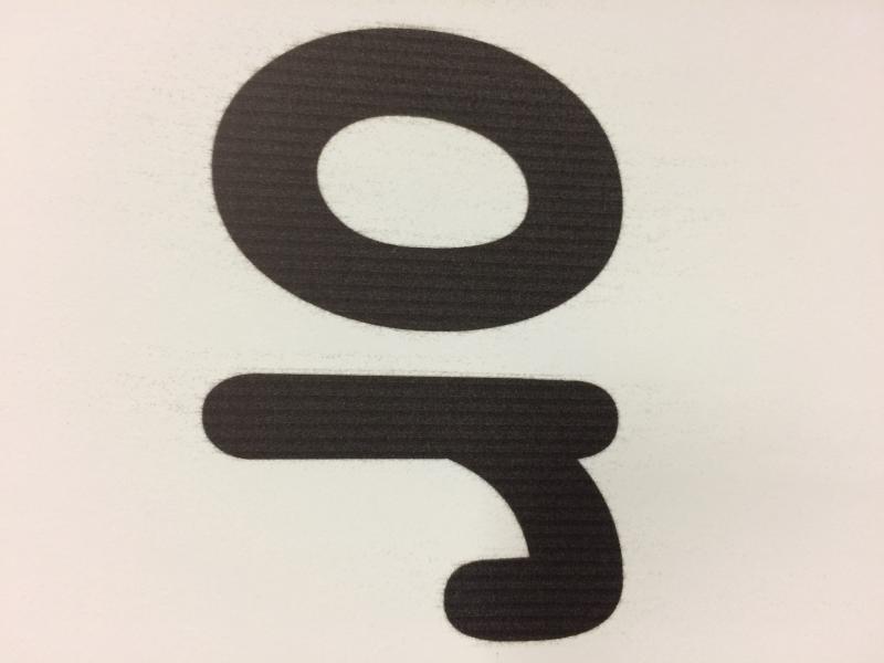

I've spoken to technical at Roland and they have advised to give the machine a proper manual clean and to get back to them if it is still like it. I have done one and left some solution in the capping station and it improved a little, so am wanting to do another one as I didn't remove all the splodges of black ink, which I hope isn't leaking from somewhere but every time I click the manual cleaning button, it tells me to remove the sheet, which i do, but because I've moved the lever to remove the sheet, it restarts and tells me to put the sheet in, so i'm going round in circles. Am I missing something obvious as it worked a couple of days ago? Roland also suggested replacing the wiper and felt pad, so will do that next if it doesn't help as there is lots of black ink in that section.

You remove the sheet first then select manual head cleaning, run a small print job first if you like before doing this. You should replace the felt pad and wiper anyway, they both aid the cleaning process. The wiper can be cleaned if you dont have a spare but they do wear and don't cost much. If it's under warranty fit a genuine items wiper/felt pad. Out of interest what inks are you using?

I've done some more manual cleans and poured solution in the capping station and no change. I'm going to try some more standard and medium cleans and cleaning the actual head next. I think I did one or two power cleans in the beginning but Roland suggested not doing this as it uses lots of ink, but they say that it's likely the head, which is £1500 plus I'm guessing vat and labour. Just for them to come and look is £400! I've had 2 or 3 paper jams since i've had it so maybe i've damaged the head then?
