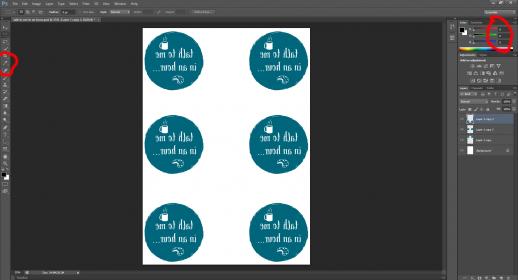

Can you do a screen shot of the PHOTOSHOP screen with your artwork open?
I have a feeling it is just down to colour adjustment and you will be fine.

Re: Where am I going wrong?
I appreciate your help.socialgiraffe;139553 wrote:Can you do a screen shot of the PHOTOSHOP screen with your artwork open?
https://ibb.co/0YjtSfY
Thanks.
If you click on the eye dropper tool, then click anywhere in the colour the right hand RGB value should be around 0, 102, 123. It looks pretty close to be honest.
