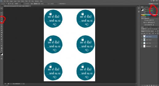

Re: Where am I going wrong?
Can you do a screen shot of the PHOTOSHOP screen with your artwork open?
I have a feeling it is just down to colour adjustment and you will be fine.
Rusty
Posts: 13
Joined: 15 Aug 2019, 14:24
Post by Rusty »
socialgiraffe;139553 wrote:Can you do a screen shot of the PHOTOSHOP screen with your artwork open?
I appreciate your help.
https://ibb.co/0YjtSfY
Thanks.
If you click on the eye dropper tool, then click anywhere in the colour the right hand RGB value should be around 0, 102, 123. It looks pretty close to be honest.

[QUOTE=socialgiraffe;139555]If you click on the eye dropper tool, then click anywhere in the colour the right hand RGB value should be around 0, 102, 123. It looks pretty close to be honest.
Have you made sure that GLOSSY paper is selected in the advanced printer properties?
I will tag Ink Experts as they are far more skilled in this area than me, given all the information you have provided then it should be a really simple fix.[/QUOTE]
It is indeed 0, 102, 123.
