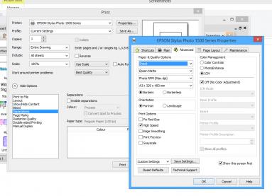

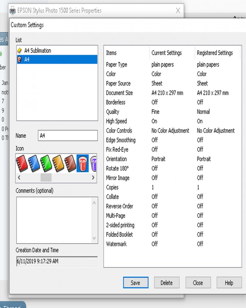

one thing i do seem to be struggling with is the icc for the epson as the info that came with the profile seems to be for a newer version of epson software so some of the things im supposed to select or switch off i can't find,
Are these the correct settings in the printer

vB_ID:5770
vB_ID:5770
Screenshot (7).jpg (19.14 KiB) Viewed 370 times
