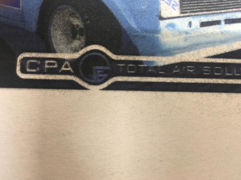

Thanks for all the quick replies. Looks like I have the colour back (replaced yellow out of date). I now have a problem where the print is coming out really fuzzy. Attached is an example. The letters CPA & outline shows ould be solid white.
