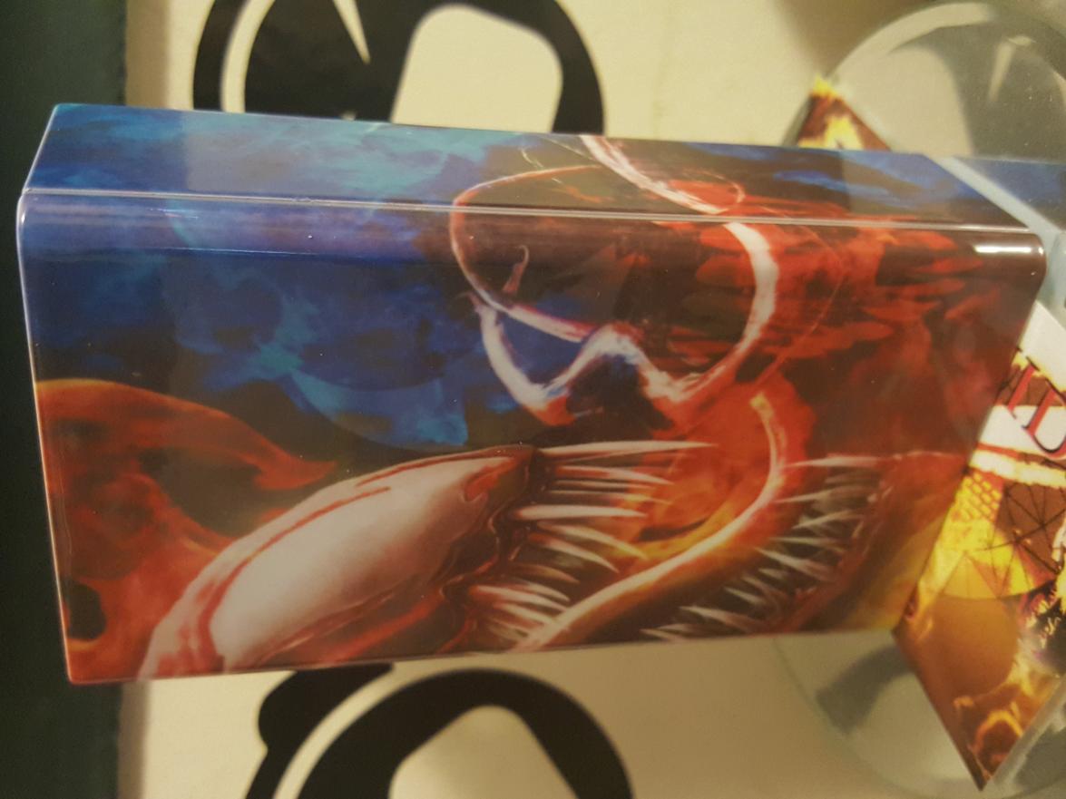

I only press it once. The clear coat I cure in oven. The products I mIe need a good clear coat to protect the product from the abuse of everyday use [ATTACH=CONFIG]5521[/ATTACH]

So is that some sort of plastic case which you have sprayed with a white polyester coating such as Subli-Glaze/ Digi Coat)?

Is the clear coat really necessary? Sublimation aluminium has a polyester film which stands up to everyday use.
There are other coatings and lacquers which crafters and jewellers use to protect designs etc.
Not sure what the product is, but if you couldn't get it to work, you could perhaps just decorate the top of the product with a thin piece of sublimation aluminium. It's hard to know what alternatives to suggest without knowing the product.
