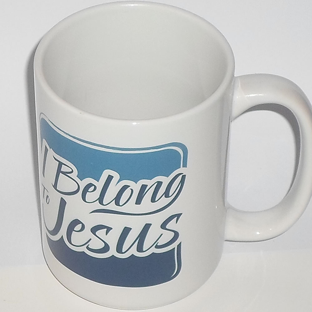

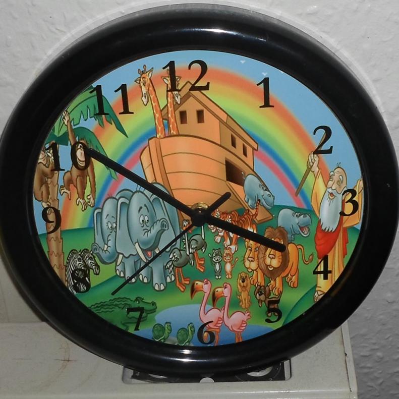

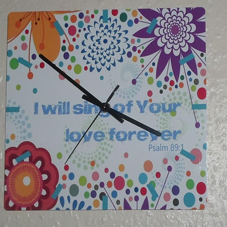

At the moment I'm using the Surrey Inkjet Company 130gsm matt photo paper because I like the weight of the paper and while not the cheapest gives a nice finish.
The round clock is on mdf hardboard, the square clock is aluminium and the mug is ceramic

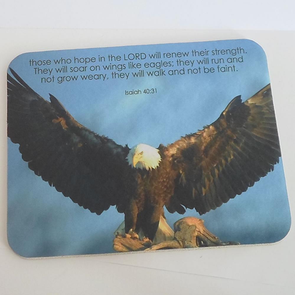

I don't know if it works on t-shirts etc as I don't do those but I did a print on a mouse mat which has a fabric top and it works fine.
Generally, I print everything at 180 for 180 but for mouse mat because of the smell I did 180 for 120 seconds

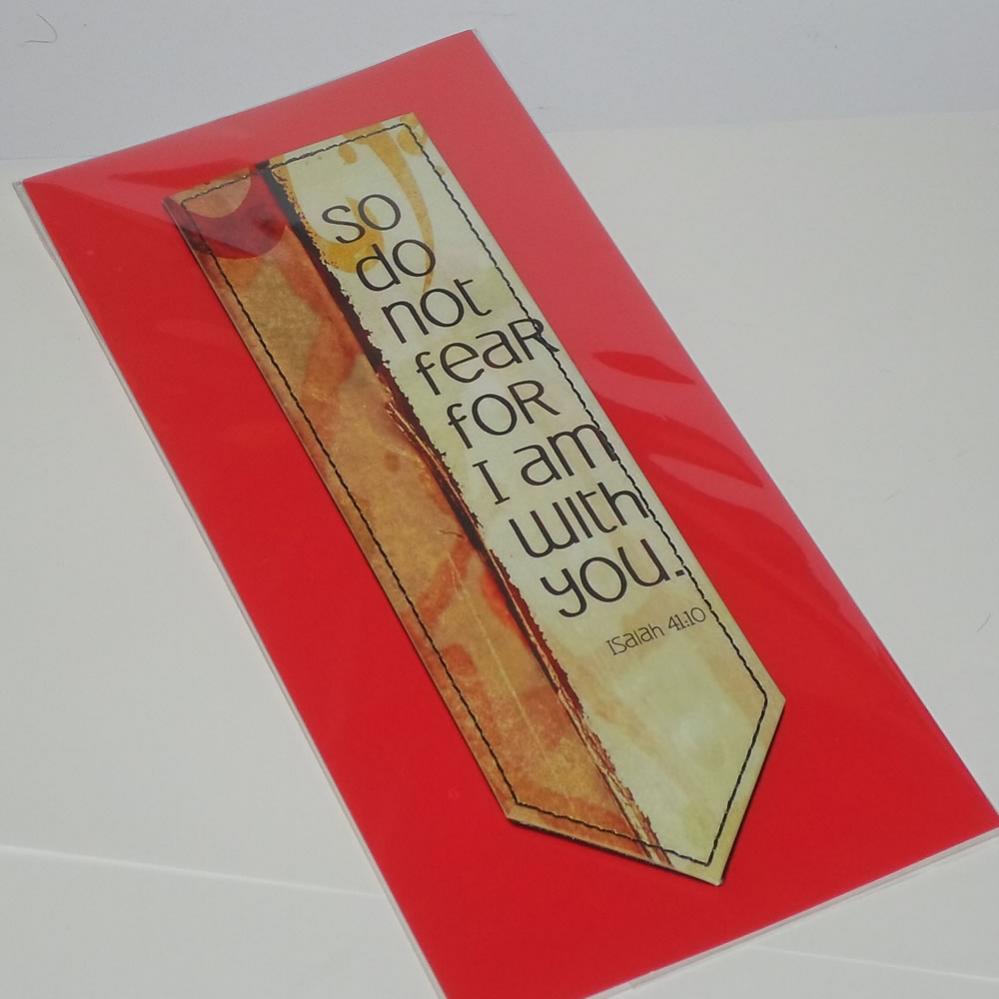

and PU leather I do at 180 for 60 seconds to try and stop the texture on the back from melting away :)
