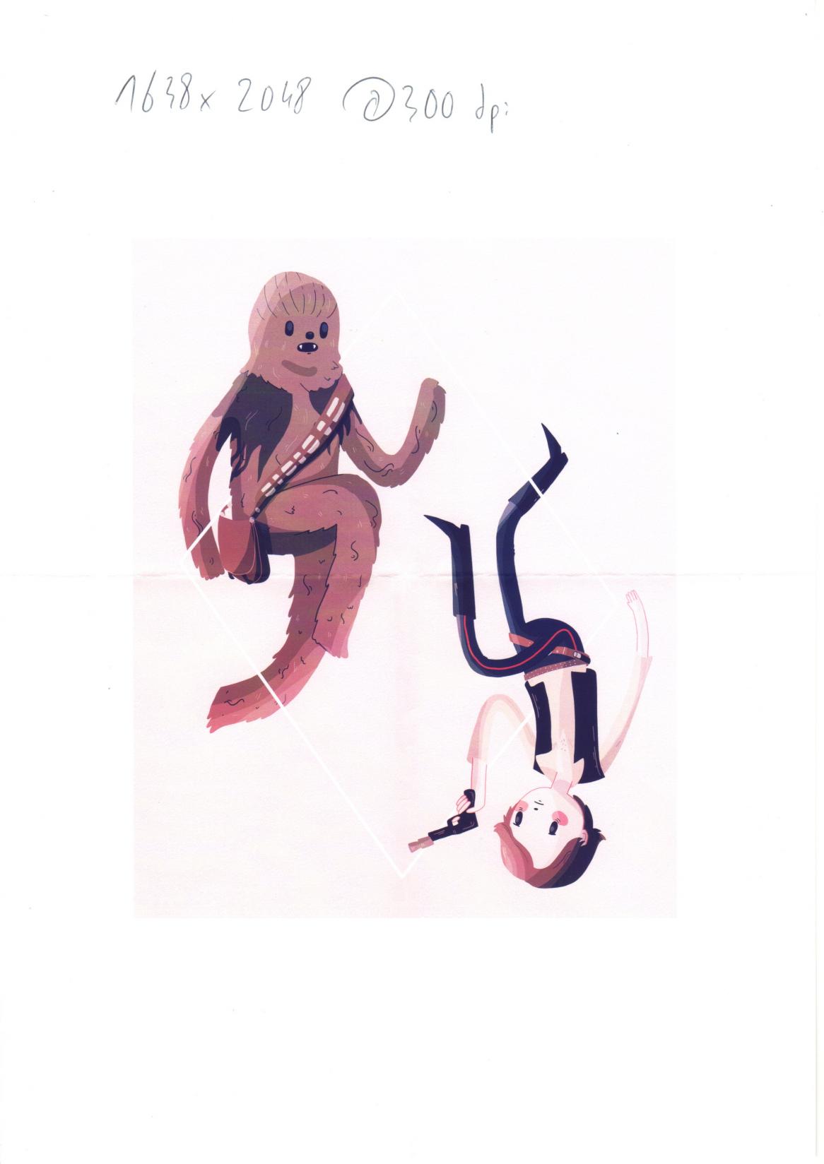

Ok I scanned a print I made today. When you look closely (you need to zoom to 100%), there are small black dots on the white/pink.

malkram, you mean the square around the picture (looks a little pinky) ?
That's not there on this one....

I'm not talking about the square. In fact the defects can be better seen when you got the print in front of your eyes. Hey I see you have a 3110, it's almost the same as SG 400, could you print my image if I send it to you and send me a pic ? @scotty44
