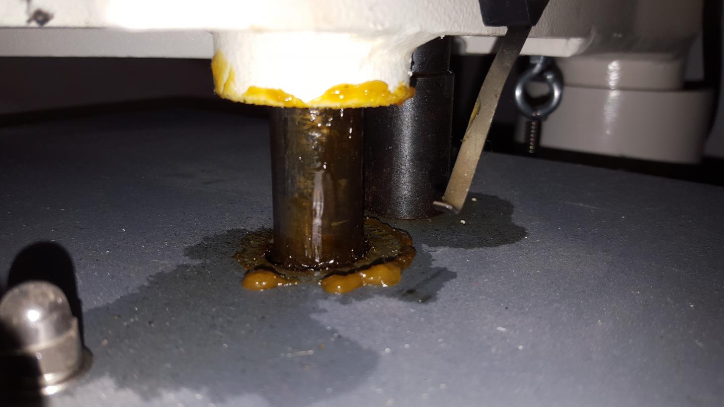

Similar probem a while back, upper plate kept on sticking when lowered. Liberal application of high temp grease on the guide spigot sorted that. Looking at the video you may have some loose fixings on the support bar by the lever mechanism, or internally. Easy to check by popping the lid, hex screw at rear has to be removed completely plus screw holding lid to swing handle bracket plus pressure control knob. The latter needs the retaining pin driving out with a parallel punch.

I unscrewed the lid, made sure everything is tight, which it is. But the support slider seems to have to much room & play in it, same with the handle section hence the mole grips stopping the handle from moving around, I'll re-grease everything tomorrow perhaps it help some issues

they get wear on the spindle and youll need a new one not cheap my broth in law just replaced his. poor design really.
