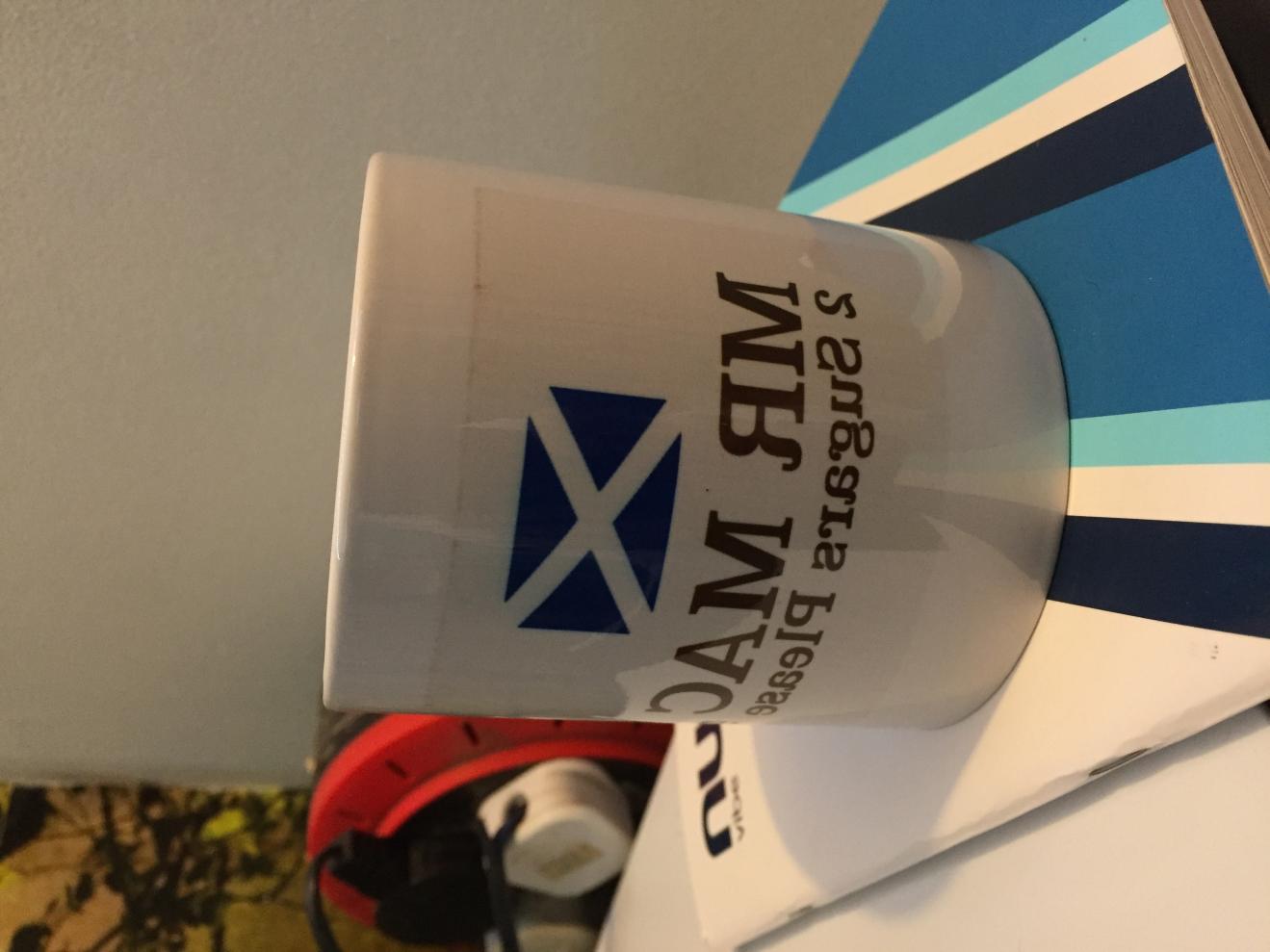

Well, The seller sent me some ICC profiles, had a right mare getting them to work on one of my accounts on the mac, googled its with the new OS, i've followed there walk around but no lucky!
I've got the profiles on my admin account so i've been playing around, i know i didn't flip it, school boy error, im learning but thats not my problem.
the blue in the flag looks alright, little blurry round the edges, but i expanded a jpg, possibly its that and there is a clear box where i've the paper has been and that doesn't come off.
I've been pressing on 180 for 120 secs.
Any ideas?

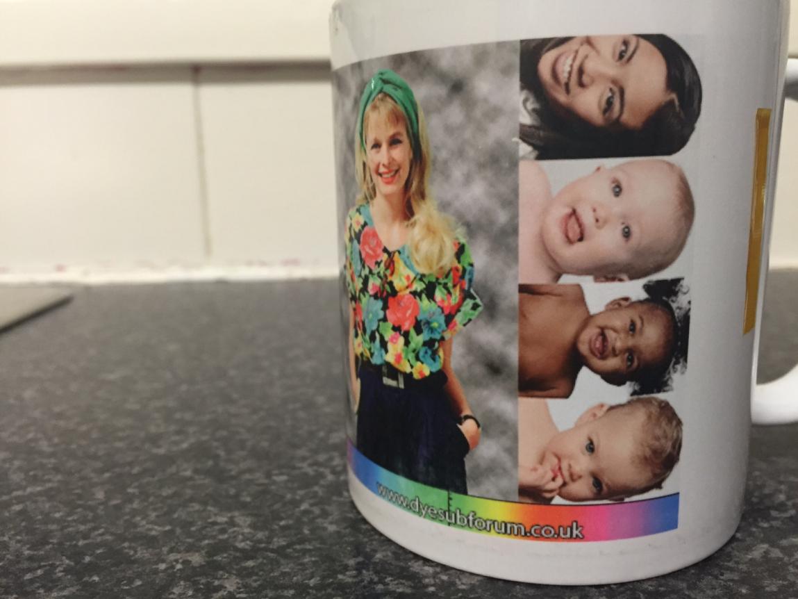

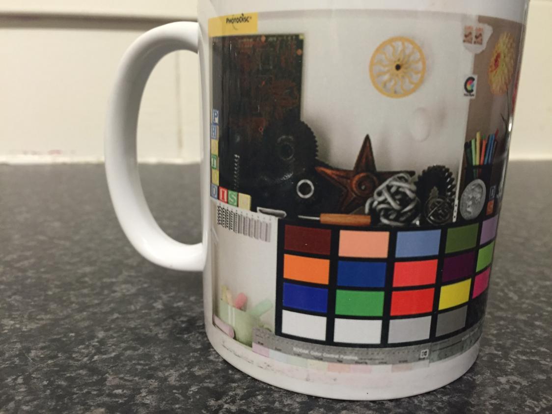

your ink could be of good quality but you will need to use right settings to get most out of it. your photos in did show profile issues.
I would also recommend to run nozzle check to make sure all nozzles are working.
ps. when you trying new profile, use photo with more then one or two colours.
try this image as it contains all data you could possibly need. Gradients, colours, skin tones.

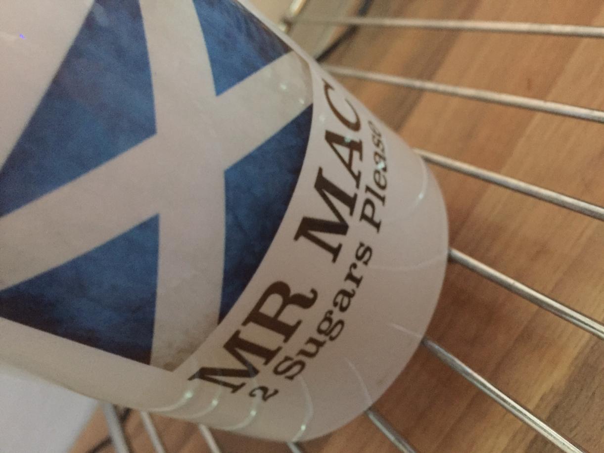

Thanks Paul, that printed a treat, i've changed my temp to 170 for 120 seconds now too, do you know why the black works on the photo you sent be but i brought some text into the same file, deleted the background (your image) then added some text to it in black and a scottish flag from google but the text is still pressing browny/patchy almost.

Could be you are printing with photoshop and using that default US profile that catches many people out.
Re: Print quality and colours are poor.
I am printing with Photoshop, I've changed the profile to the ICC Profile i got from the eBay guy.
Could you explain a bit more incase that is the reason.
Ricky
Ricky
You need a document workspace profile of Adobe RGB 1998, and the profile you have been supplied is for the printer (when you go to print, select photoshop manages colours, and the supplied printer profile here)

https://www.dropbox.com/sh/yo6w7evagi3p ... x2Aka?dl=0 - These are some i've done using them, i've about sussed the profiles but i recon my heat press / temp / time could be causing the black to go patchy.
https://www.dropbox.com/sh/blso6f0tjihl ... KsMda?dl=0 I know the image color isn't great on phone camera with the glare from the glass doesn't help either but i hope you can see that the start of the print is fine, black, little bit fuzzy but the black is black, as it works round there is a patch on the y and g and a little patch on the ee where it's not black, it's more brown and it seems to leave a light grey overlay where my paper is.
