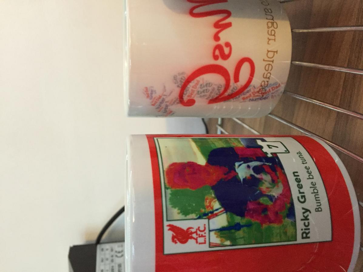

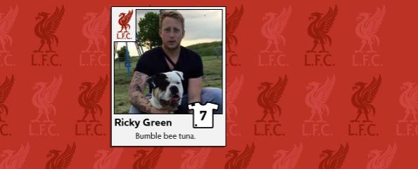

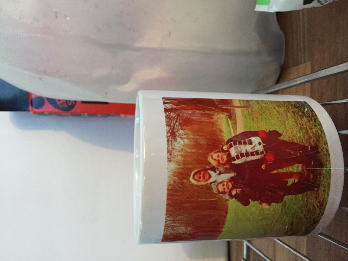

I've ran some tests, the first image is my last attempt, the color is very orange, this is the original.

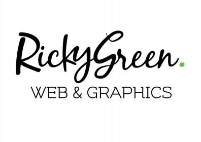

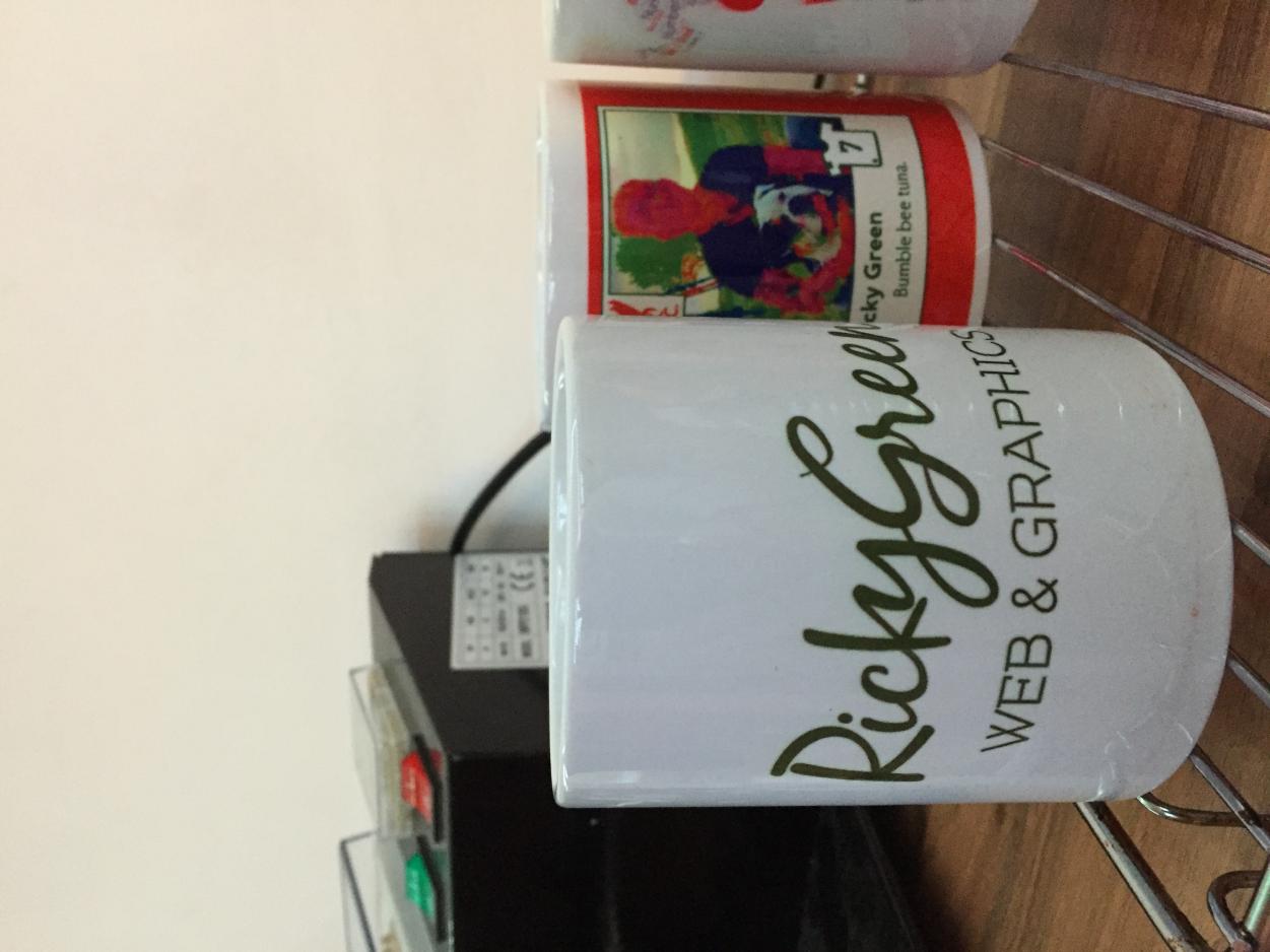

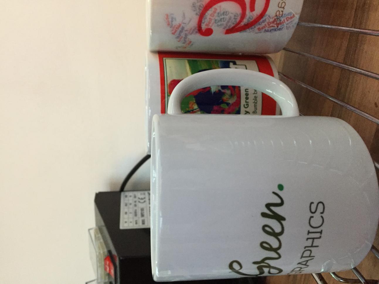

So i tried a basic design, just my logo but the black isn't even black, its more like green
This is my first attempt, its awful
