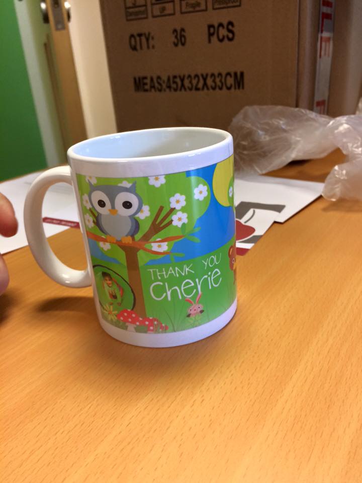

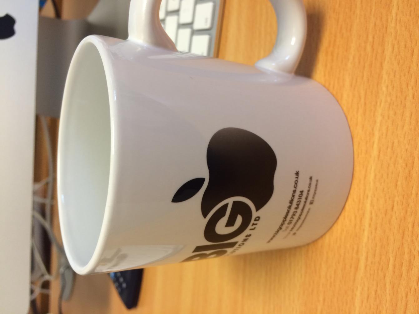

cherrydesigns
Posts: 15
Joined: 15 Jul 2015, 10:29
Re: Mug Press issue
Post by cherrydesigns »
vB_ID:3600
vB_ID:3600
vB_ID:3600
vB_ID:3600
vB_ID:3600
vB_ID:3600
vB_ID:3600
vB_ID:3600
Kind Regards
Richard
Cherry Designs
Tel: 01793 781662
KathG
Posts: 268
Joined: 28 Jan 2015, 17:34
Re: Mug Press issue
Post by KathG »
Hi again. Umm the design looks enough away from the handle. The black looks ok too. The only thing I can think of is pressure and making sure your paper fits tightly around the mug. Up to now the only time I have that problem is if I get the design too near the handle.
Hopefully someone else will chirp in with some other ideas.
Cheers
kath
Cheers
Kath
cherrydesigns
Posts: 15
Re: Mug Press issue
Hiya, thank you - I setup the colour profile just fine, that sorted that. I also did some test runs and it came out fine, however. I've realised that if I do like these photos, it comes out just about okay.
vB_ID:3604
vB_ID:3604
