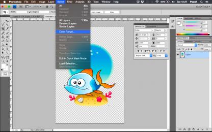

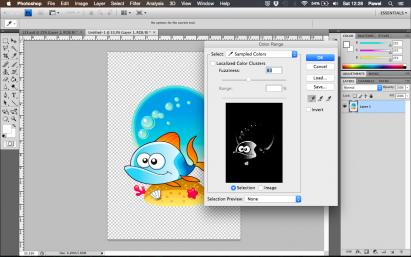

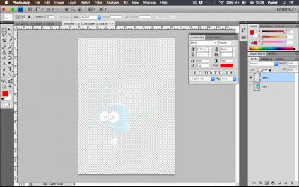

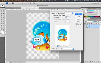

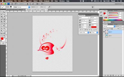

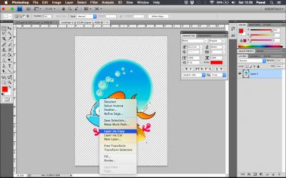

good way of doing it.
I do it other way, but i think yours is actually easier.
my way:

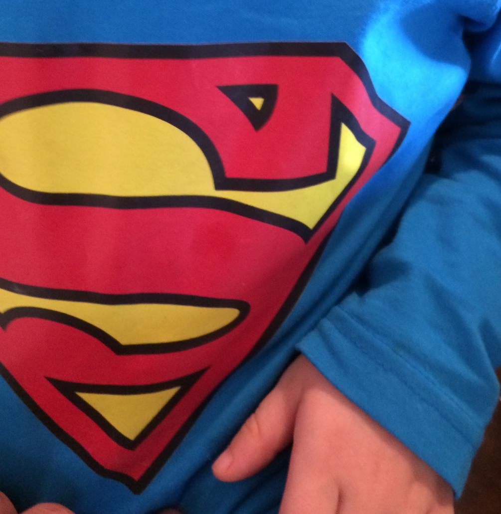

Thanks guys, will have a play with some designs soon, but I did make my son a superman jumper and the print came out stunning using ultra bright papers and my oki c610

Here is my sons Tshirt I did using ultra bright
