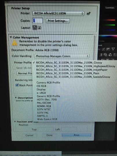

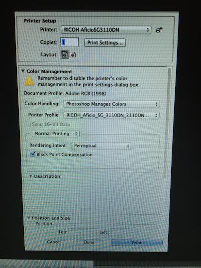

I have attached an image of my current settings, any help would be much appreciated!!
I have also attached a list of the printer profiles that are on my drop down list. (I have only tried two of them, Glossy and Inkjet paper.. Glossy being the better)

Looks to me like you might be using a Mac, so the powerdriver will be a no go, but the ICC profile your using in your screenshots are the standard Ricoh ones, not the Sawgrass ones that you will need to use.

If you have PS then you don't want PowerDriver, the correct ICC profile for your ink/printer is the best solution, Sawgrass can supply you one.

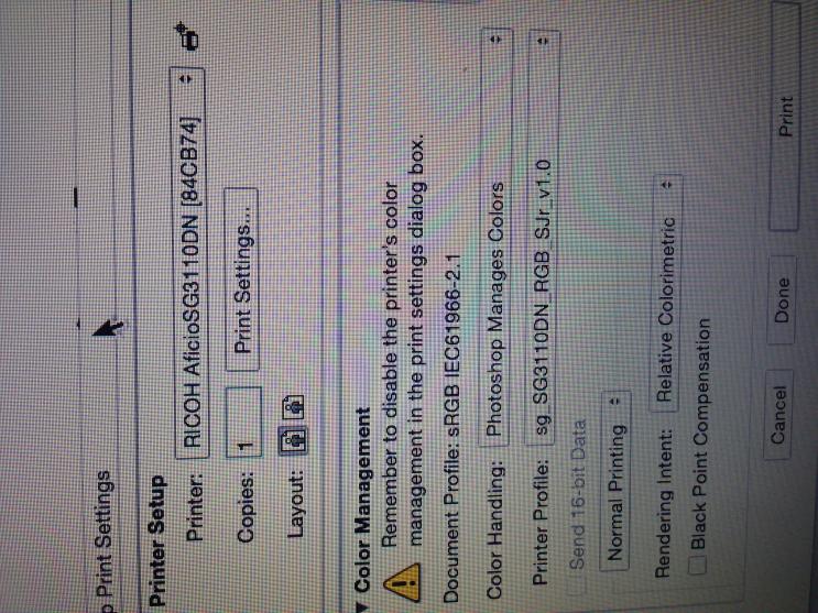

hi nick, sorry to jump in, I've been having trouble with colours not spot on etc, this is the icc I'm using is this right? Mac 10.10.1
Re: Ricoh SG3110DN - Photoshop cs6 print problems.
NO, you need to update that profile.
