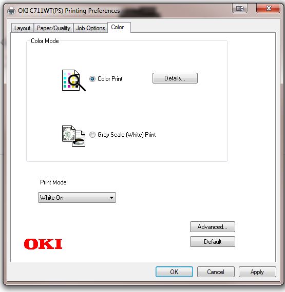

Gygafo;92871 wrote: If I were to print from Cameo Studio it goes via the normal Oki colour printer driver and obviously prints white where you dont want it.
Hi Nigel,
The OKI C711WT driver has the 'white on'/'white off' option. Is this option not available when using the Cameo?

Hi Skye, yes there is the option and I don't know how I missed it, was probably looking too hard. However, there is a need to pass the print through Space Control for the use of different media as they have different heat and colour settings that aren't available via the standard printer driver and I want to have the ability to cut different media.

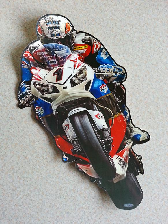

This is early days and if I improve the process I'll let you know. Ive attached (I hope) a picture of a OBM transfer. It's still attached to the paper so there is a little white around the edge but perfect when peeled ready to apply.
