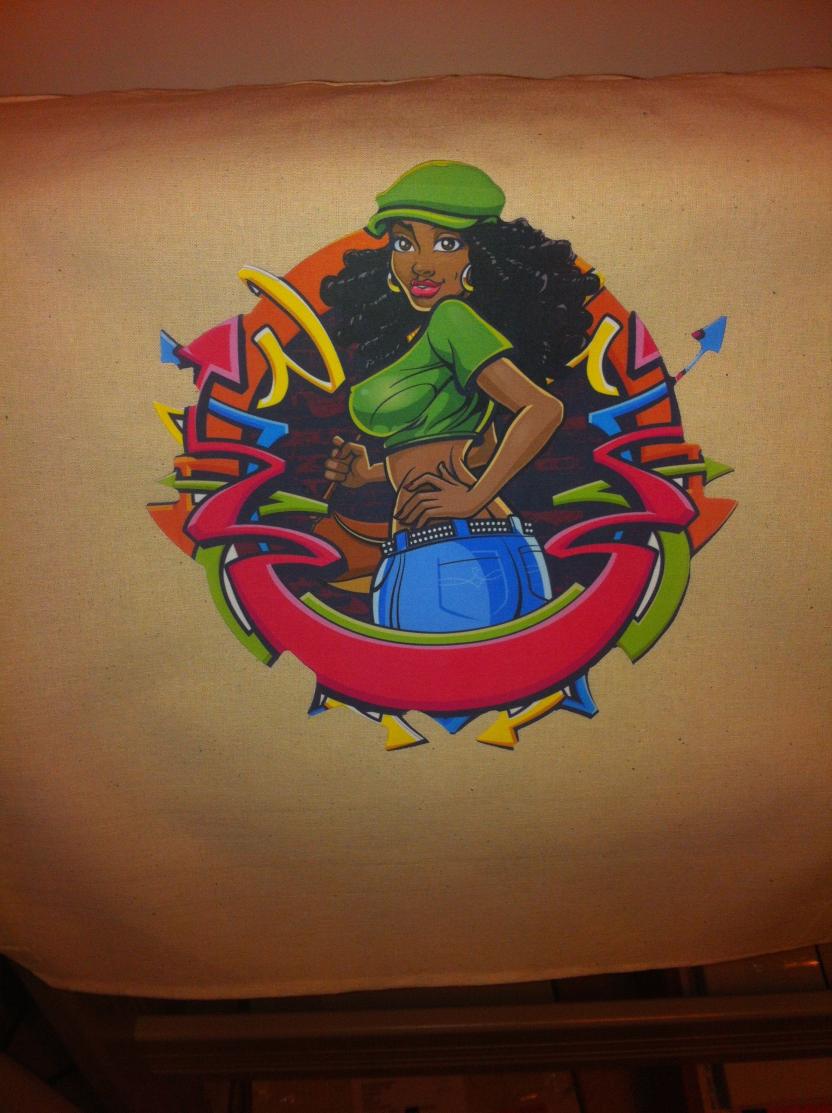

I wonder how cameo perform with cutting subli flock? any one tried it? I am looking to buy cameo so i can contour cut smaller logos out of subli flock. thats all.
so all views are welcomed :)
my graphics won't be more complicated then this;
