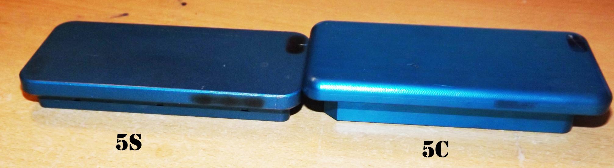

Quick one,
Will a heating puck for a 5s fit a 3d case for a 5c? when put on a dummy phone to cool, it will shrink to the right shape??
thanks

Yes, same puck for both models.

we-print;92466 wrote:Quick one,
thanks
I don't think 5S would fit a 5C case, they are very different shaped. The case might technically fit on the puck, but it's not the correct one to use for sure.

no they are not the same...trust me on this. 5 & 5s are same puck....but 5c totally different
the 5c puck is more rounded and also make sure you get the proper 5c dummy phone case...we have solved our problem with our 3d 5c cases sagging after printing....
ALL the 3 dummy cases we bought on ebay were iphone 5s cases.....i just went and bought a real, but broken iphone 5c..and its def rounded at corners and around the back.....problem solved with sagging middle after print

just to show you guys the diff pucks/molds for the 5s and 5c cases
