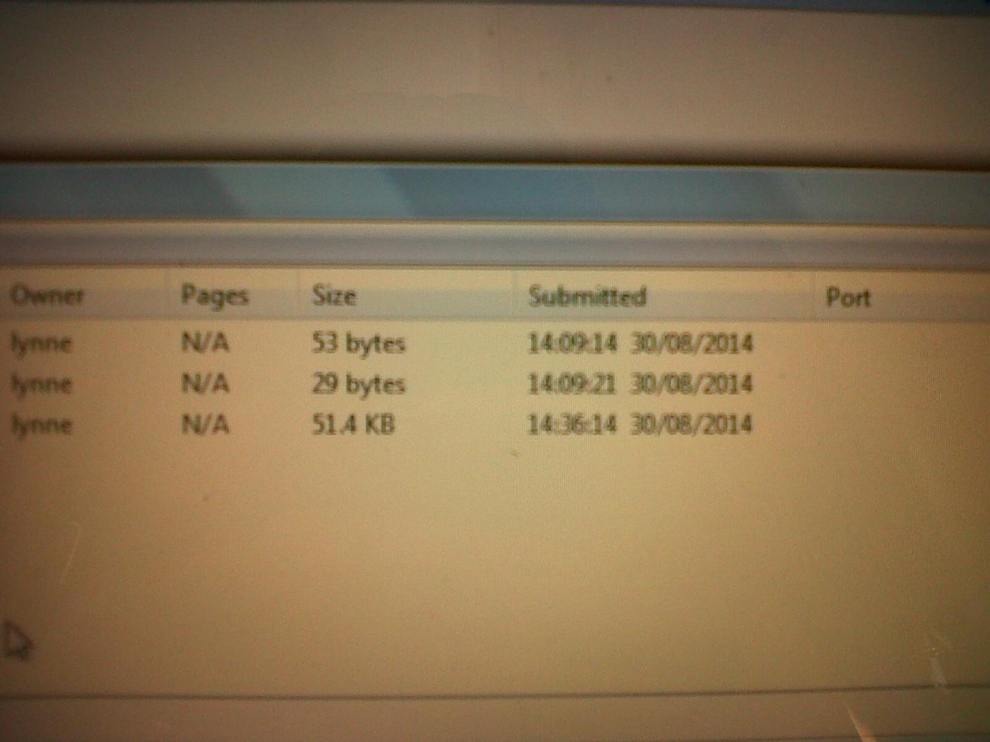

[ATTACH=CONFIG]2944[/ATTACH]ok so i may be winning! i now have a connection i think. Tho shouldt i have a port? and why is it saying printer offline when it so isnt...

Ah, this is it - You must assign it a port.
There is a Gear type icon from memory which is where these settings are (in Flexi) and then you have to assign the port also in the driver - will fire my system up later if you are still having problems as I cant remember off the top of my head how it works but you are on the home straight.
.. actually, the port settings are in the production manager which opens when you send a job to the cutter (just remembered).
