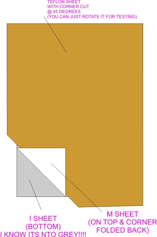

Below is what I do (bear in mind that I have a WOW pad and then a piece of release paper (for protection) below the i sheet)
[ATTACH=CONFIG]2923[/ATTACH]
If it is the peeling then might be worth trying the following...
PRESS at 155 degrees for 50 Seconds
This means it is very hot which means it takes longer to peel apart but also can burn your hands!!!!, I use a heat protect glove on the left hand which I place on the isheet, then with my right (glove free) hand I peel the sheets (including teflon) apart. I have found that they split perfectly every time.
TMT probably can not tell you to up the temp to this as it would breach health and safety guidelines I think.
Thanks for the A6 tip, why didn't I think of that doh!. This may not be a problem but more of a - that is how they look issue. I'm too used to looking at high quality photographs, processed in Photoshop, and then printed on expensive white paper so when I see a picture printed on a black tee using WoW 7.7 it looks to me that shaded areas appear to lack contrast and look grey or faded. I was thinking that this was down to the white coverage being set too high (too much opacity). I'll have a play in Photoshop and Space Control, It's all experience.
Thanks also for the diagram too, WoW pad and teflon sheet is the method I use but minus the release paper.
The dreaded peel... I got some new media from a different batch as I was initially having problems but so far so good. I figured the peel by trial and error and notched the temperature up a few degrees at a time as I thought my temp reading may not be quite accurate. I got to 147 degrees for 60 seconds with a fair amount of pressure and seem to be getting consistent good result.
Just out of interest, I watched the American TMT video where they use 300 degrees F which is just short of 150 degrees C for 60 seconds.
